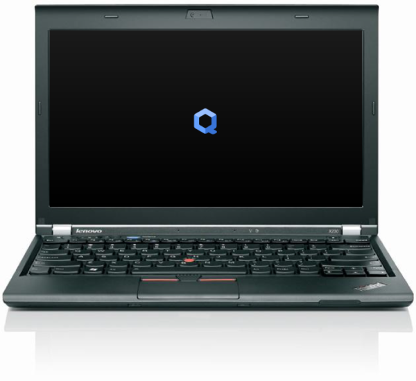

Insurgo Privacy Beast X230 - Still Available?
Insurgo Privacy Beast x230 still available?
Link returns 404
@Insurgo may be able to advise here , however the entire site seems offline currently and 404’s for me.
Is a good vendor so asking why.
It’s no longer available for a while now, unless he has changed his mind recently. He decided to put all his Heads efforts elsewhere as the PrivacyBeast wasn’t giving him the results he was hoping for (in terms of advancing the Heads project).

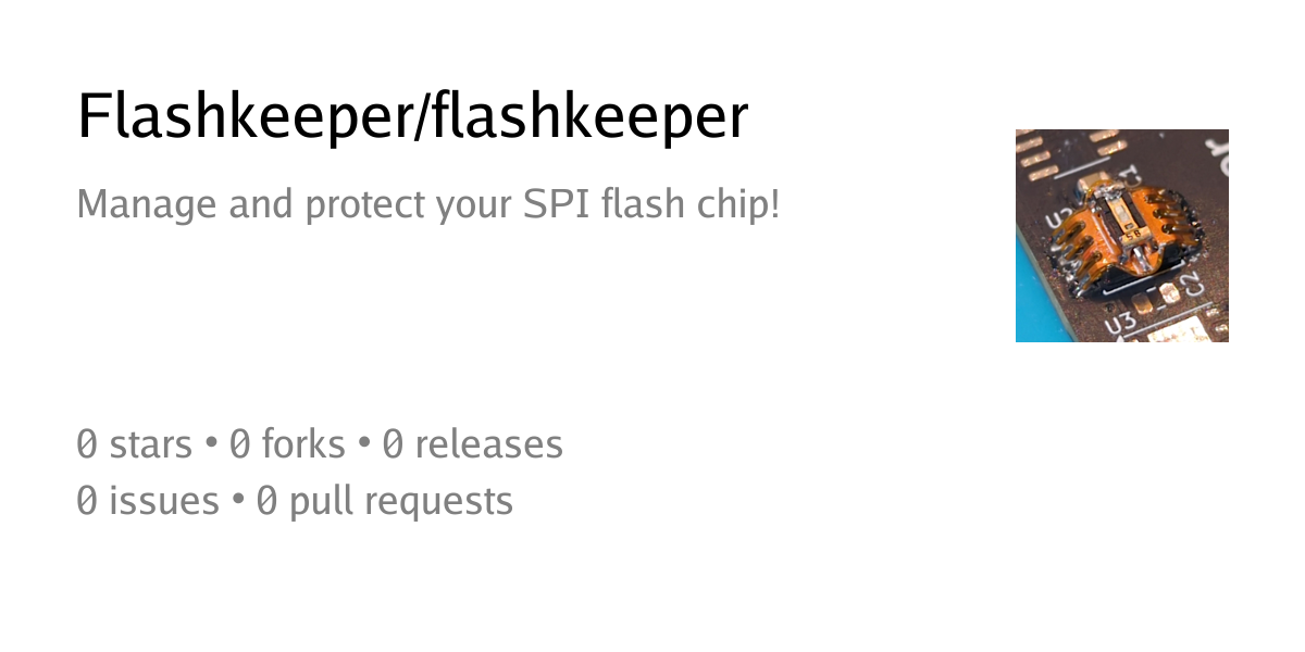

Flashkeeper, a write-protect switch in collaboration with @Dodoid to prevent the boot block from being remotely tampered with.
So what kind of chip is that? Fuses?
There are various configurations based on your use case(s), and the project itself is not fully mature just yet, so I recommend taking a look at the documentation.

https://insurgo.ca Website is back on but nothing to sell there. Heads is alive and maintained, but under funded for now. I sold the PrivacyBeast with quebeos preinstalled on older reasonably secure hardware to fund R&D. Doing so prevented me to do R&D by lack of time since doing supply chain, import export, refurbishing, reprogramming of hardware, packaging shipping returns and user support. I think I did an amazing job doing so, but at the cost of not having time to do research and development. I went NLnet funding and got some in the past (3 times now: Accessible Security, Authenticated Heads and Flashkeeper) but this alone doesn’t bring back contribution and steady funding toward Heads nor Linuxboot. Heads is a Linux payload of coreboot, and depends on kexec and whole ecosystem to move forward. This is a lot to do without more collaboration. I decided to focus on Heads while looking for more steady sponsoring, consultancy which outcome would be back into the project, or direct employment from an employer that believes into linuxboot/heads goals while being willing to pay with real money to make things progress while having economical stability to continue to do research and development.
