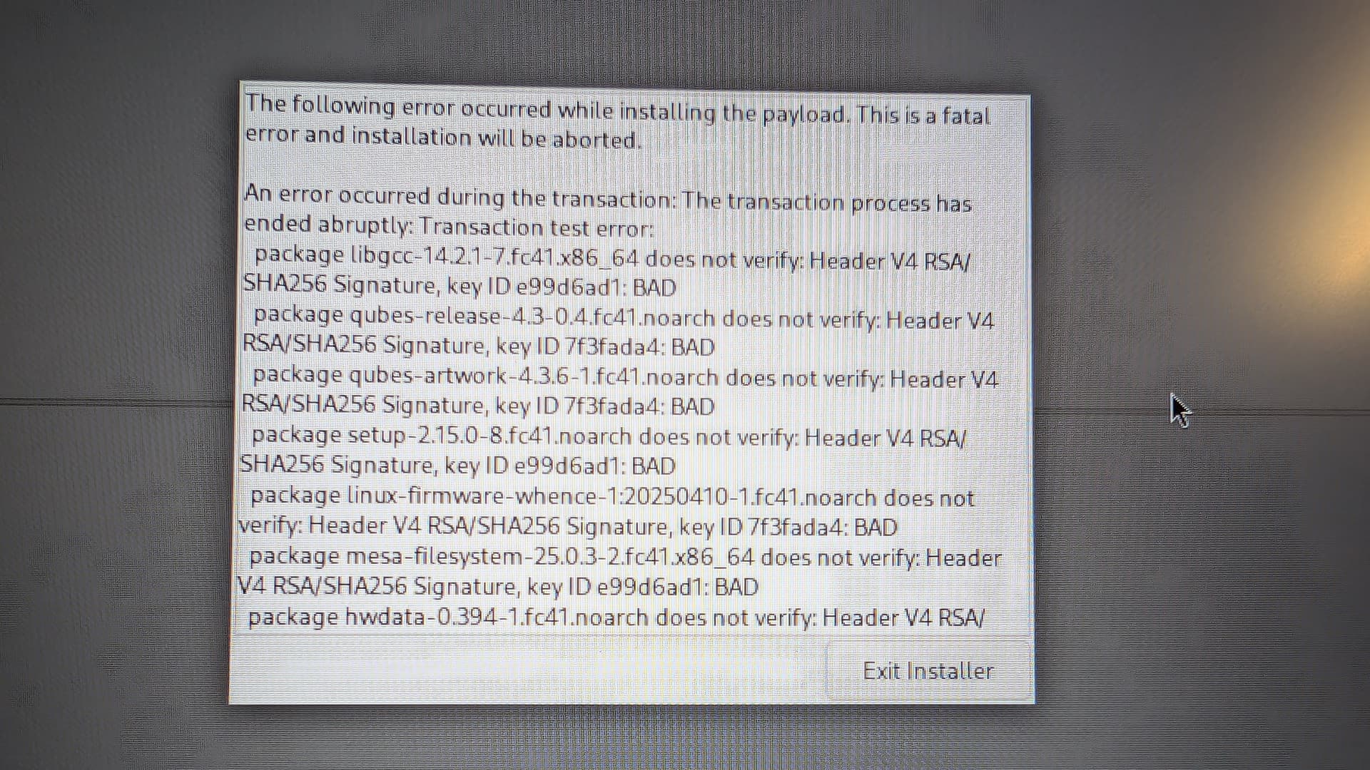

the most recent 4.3 iso failed for me.
The fatal errors occurred while installing software. Each package “does not verify” because key “BAD”.
I’ll try to attach a picture.
I got past this error by setting the correct system date in BIOS.
The problem is described in Sanity check system clock prior to installation and warn user if system time is likely to cause problems · Issue #9686 · QubesOS/qubes-issues · GitHub
