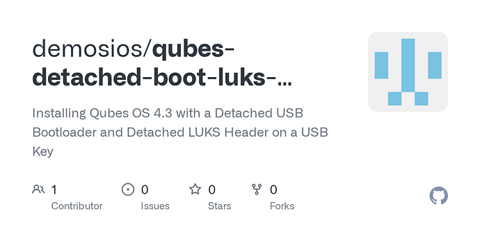

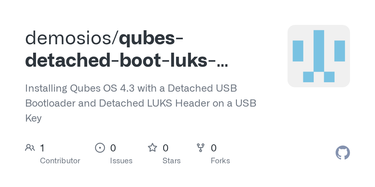

Thank you for producing this guide. I took the liberty of organising the instructions and included relevant fixes and adjustments, added some additional notes, and formatted the instructions for smoother execution and clarity. The instructions are to be found both here and in the following git repository:
Assumptions
For this guide, the devices are assumed to be:
Purpose Device
Qubes OS installer USB drive /dev/sda
USB bootloader and detached LUKS header drive /dev/sdb
Internal disk /dev/nvme0n1
Qubes OS installation partition /dev/nvme0n1p1
EFI System Partition on USB bootloader drive /dev/sdb1
/boot partition on USB bootloader drive /dev/sdb2
Detached LUKS header partition on USB bootloader drive /dev/sdb3
Opened LUKS mapper name luks
Btrfs filesystem label qubes_dom0
Warning: Device names such as /dev/sda and /dev/sdb can change between boots. Verify every device before running destructive commands.
