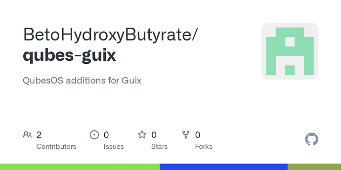

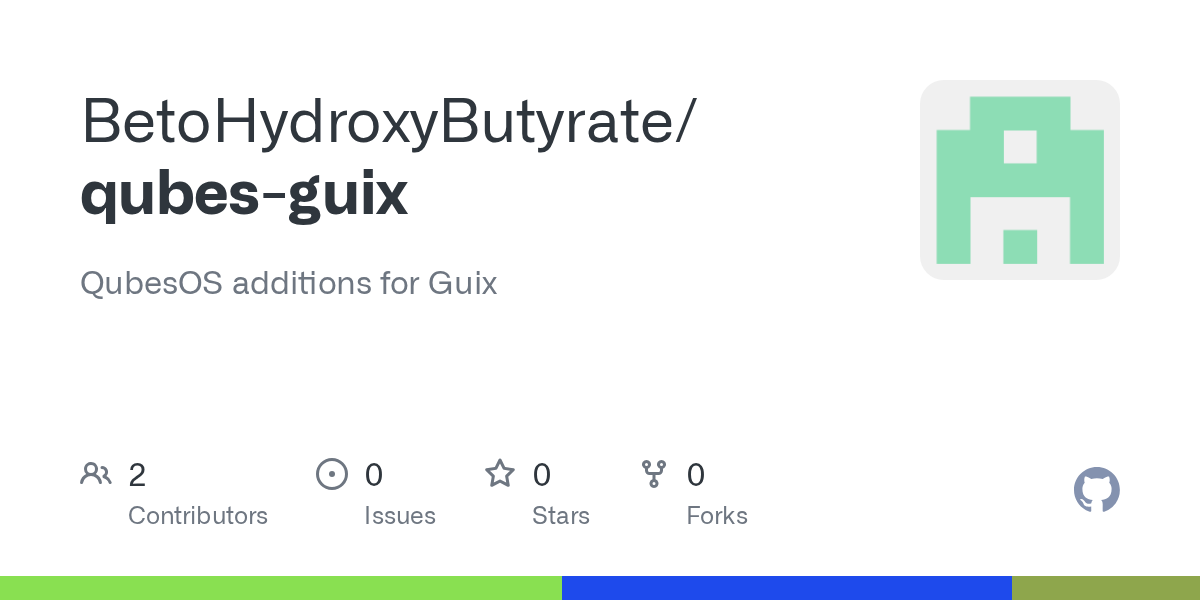

Ok. Several years later.
Me and Lumo and Claude are determined to get this working.
So far, we have qubes-core-qrexec, qubes-core-qubesdb, qubes-core-agent-linux, and qubes-linux-utils somewhat working. No tie-in yet with setting the ip4 addr from the /qubes-ip, but that will come soon – probably as soon as my IP address mysteriously changes again.
I will probably begin to focus on getting the integrated cut/paste, although qvm-run provides me with a clunky but workable cut/paste alternative.
Update: cut/paste works. Claude is a champ here. I have a hybrid situation currently where the basic XFCE guix desktop is running in one window but I can use qvm-run guix alacritty to create traditional Qubes client VM windows. cut&paste works on the latter, but fails on the former. The former is a debug/development crutch, and will probably eventually go away, though.
