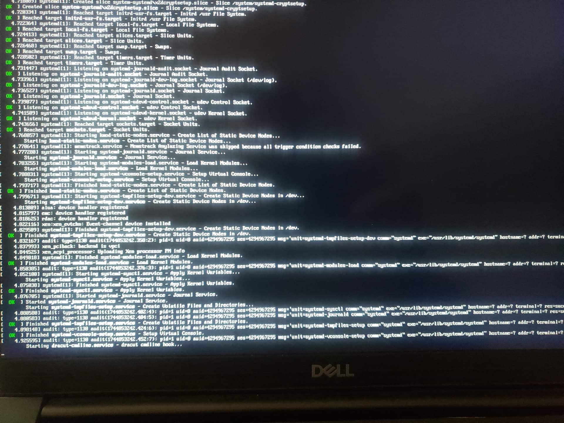

I have tried older kernel but still face with the following issue
hangs on Starting Light Manager
it’s become stuck and not working

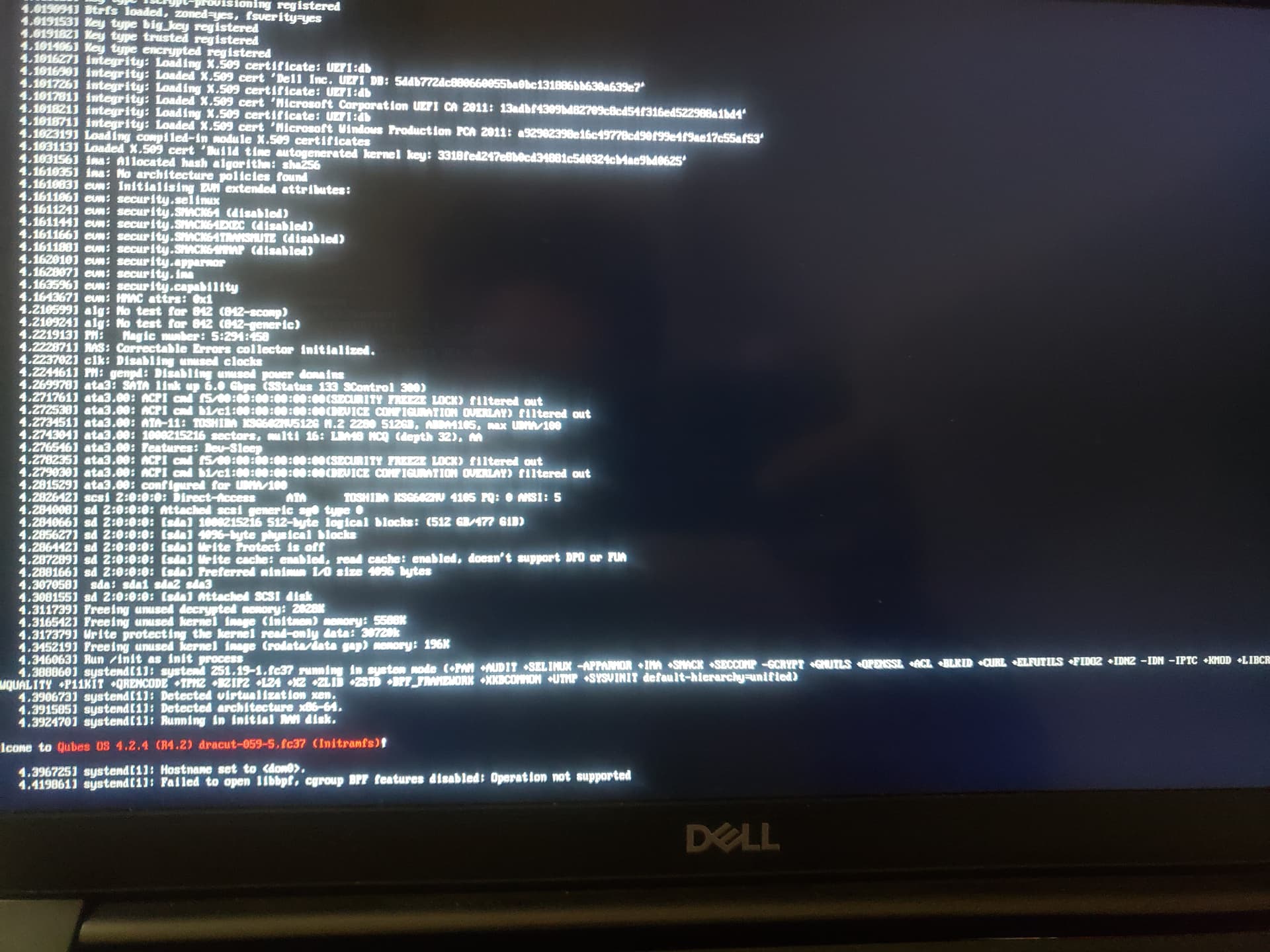

Can you try to:

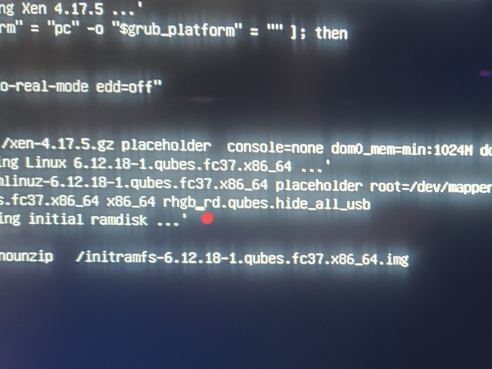

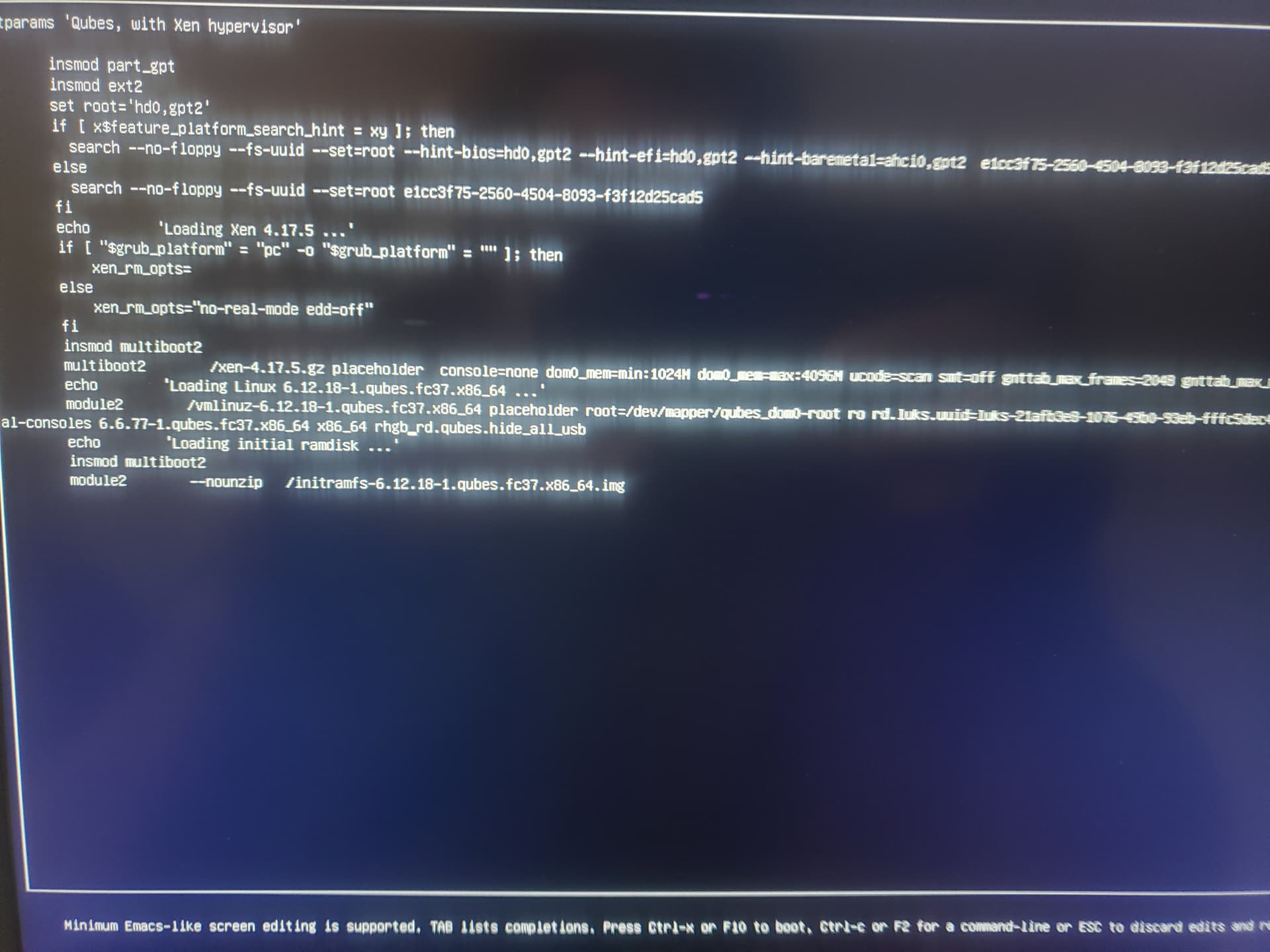

  • to hit e (to edit) the GRUB boot options and locate where it says quiet and simply remove that?
  • snap a photo of the GRUB options and share that?
  • hit Ctrl+x to boot with the edited options
  • enter your disk password and watch the messages scroll by
  • snap a second photo of the messages, when the boot process gets stuck?

I have done the process as you said
  1. I enter to GRUB
  2. I remove the quiet
  3. ctrl+x then I have received several messages only one message is in red color

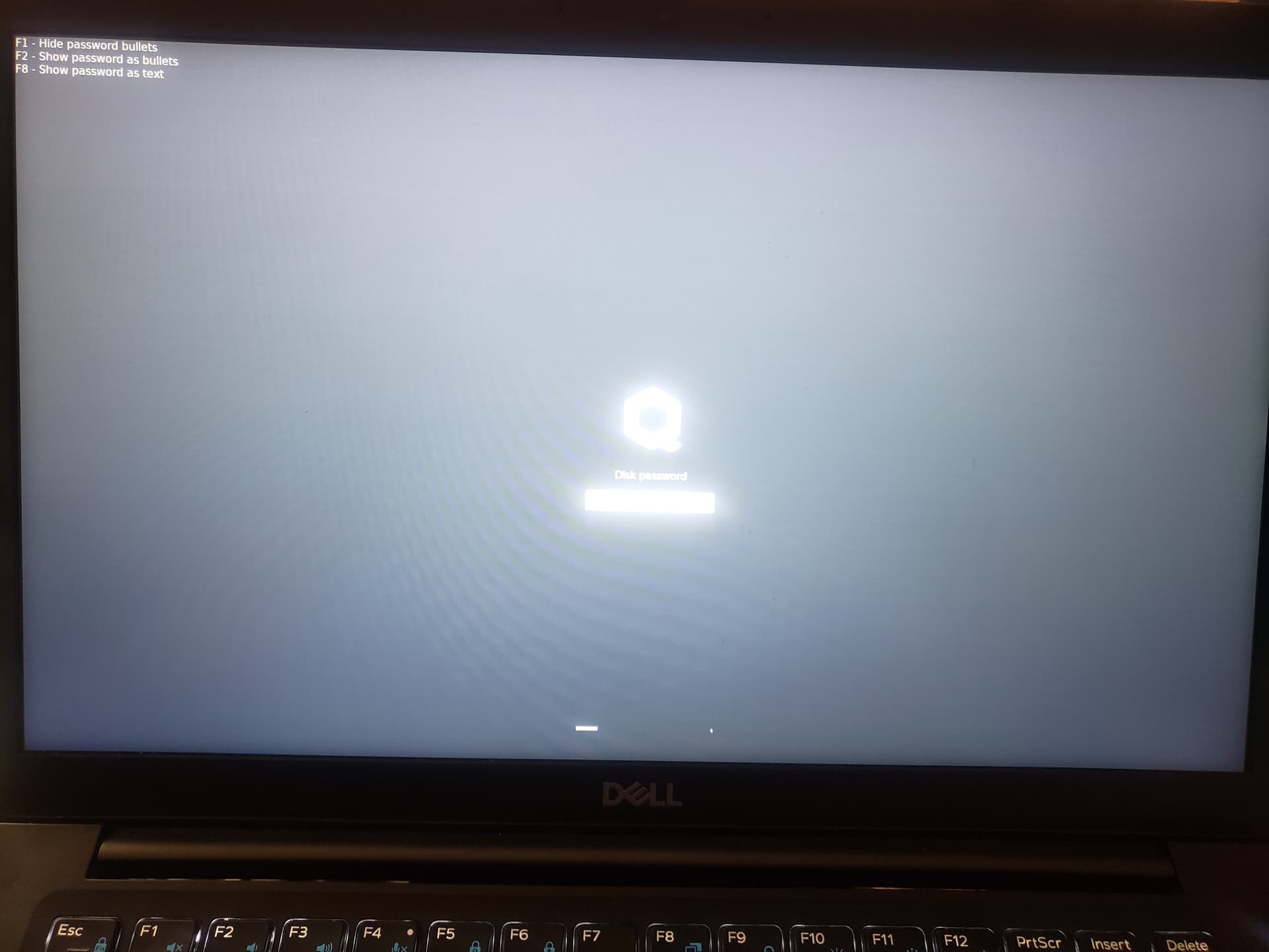

  4. When Disk password screen come nothing work, I can’t put the password. before of this process by entering the password, it’s become stuck and nothing is working.
    Yes, I have successfully done those 4 processes (install qubes reboot run intial setup login)
  1. Can you try and hit esc at the disk password screen? - does it switch to a text-prompt?
  2. Can you try to remove both quiet and rd.qubes.hide_all_usb from the GRUB line?
