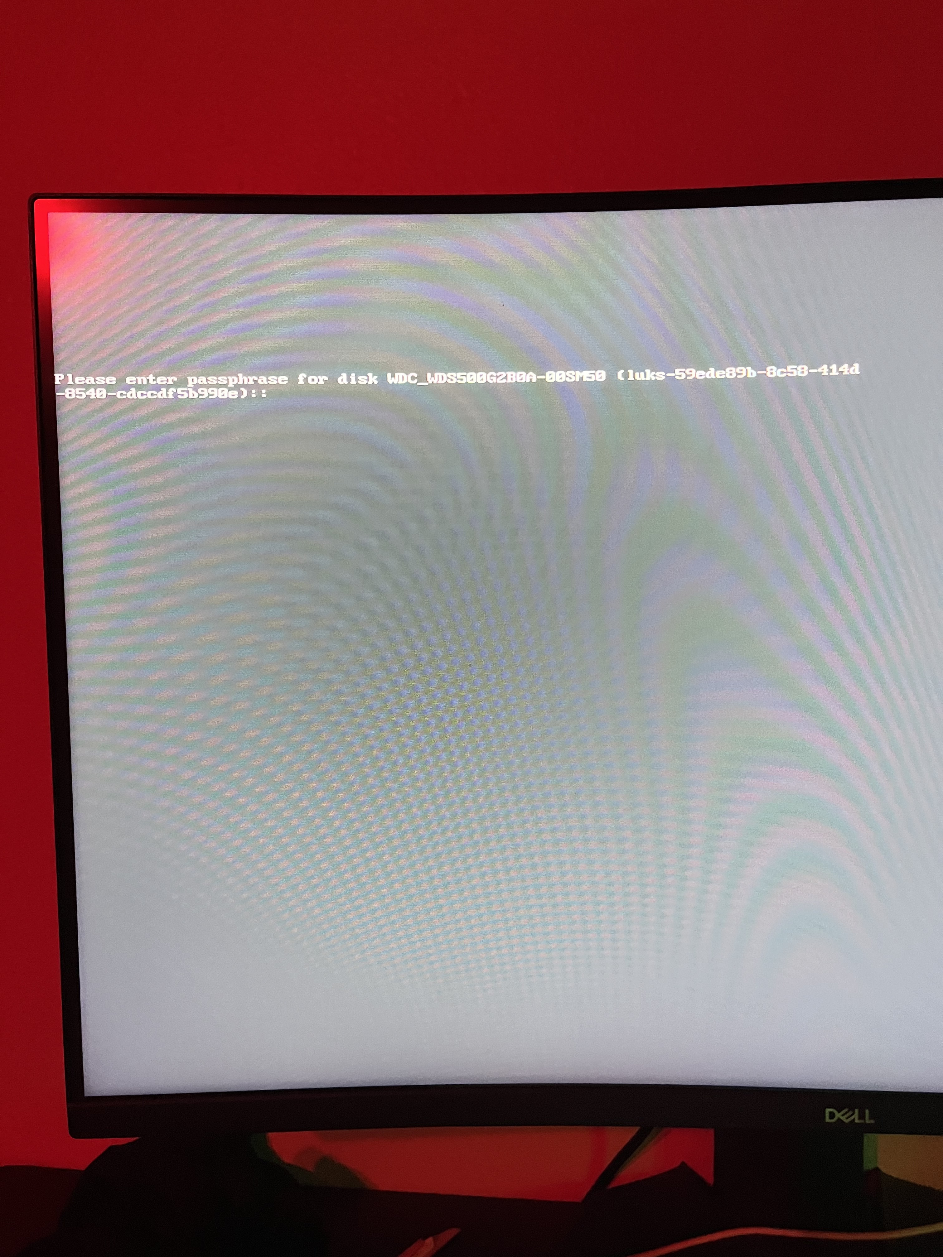

The problem is i cannot enter qubes os at all i boot qubes and the only way i can sort of log in is with TTY mode this is what my screen looks like after booting
Try different grub options (screen before this one).
Try different kernel
Try nomodeset
