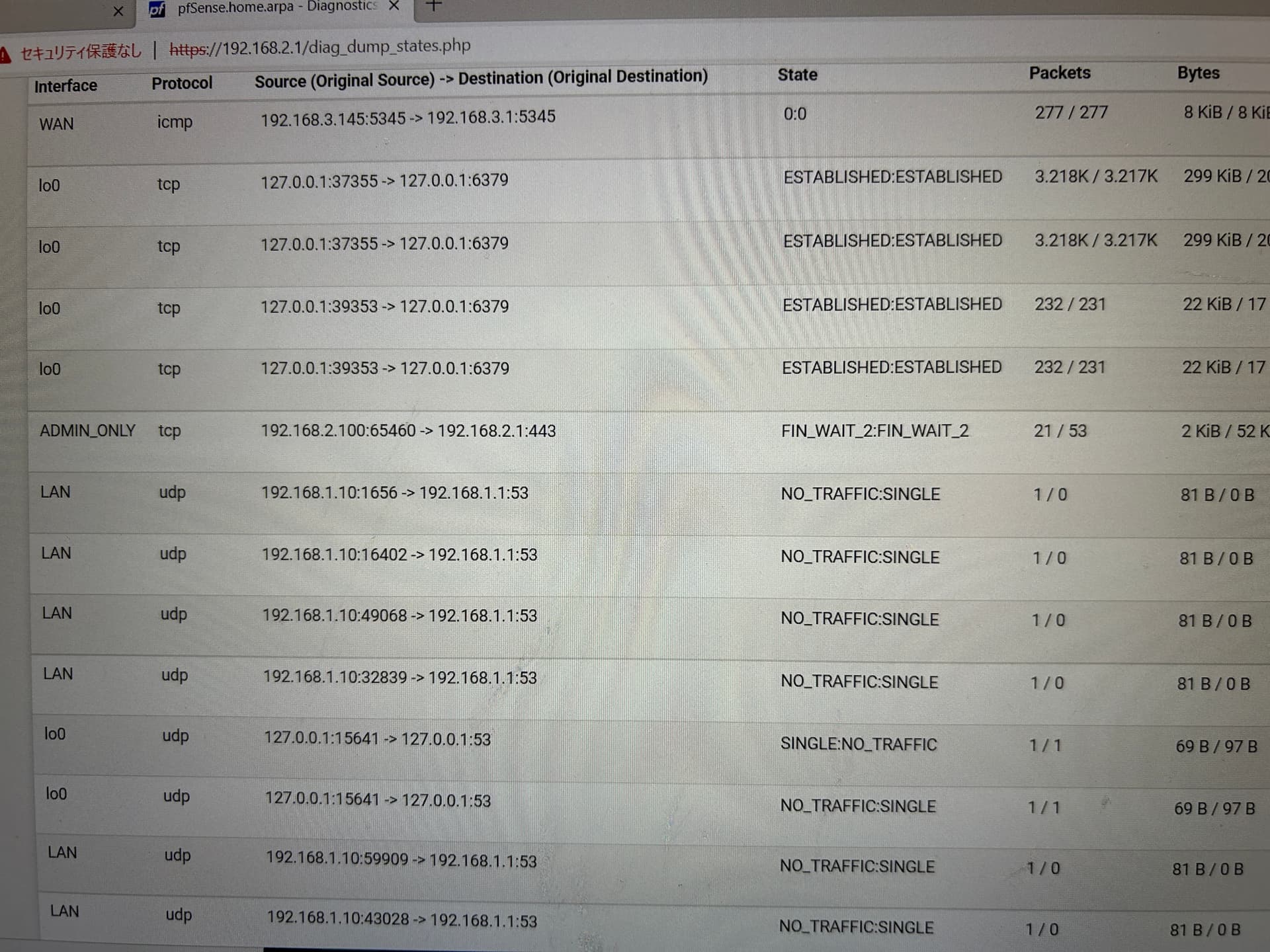

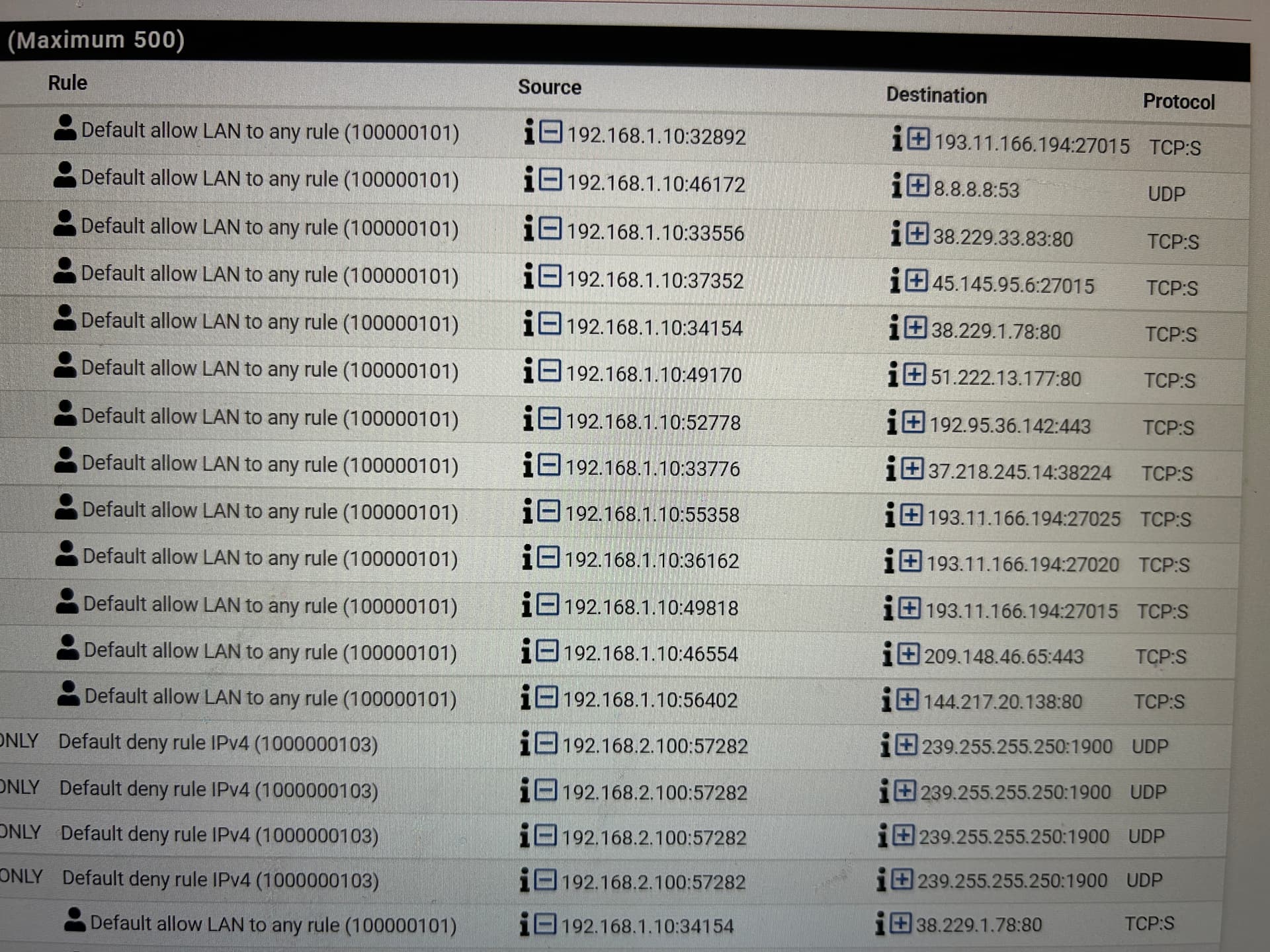

Did you try to ping the internet from your PfSense router to check if it’s not an ISP issue?
Ping seems to be coming through, I haven’t changed the PFSense settings, but I will look at the firewall logs etc. Thanks.
Communication seems to be possible in the FW logs. But the website does not appear and I get DNS_PROBE_POSSIBLE. Mystery…
Maybe you have a problem with DNS configuration in PFSense.
Try to use some public DNS server (e.g. 9.9.9.9) in sys-net for a test when ping 9.9.9.9 works but you can’t access websites.
Thanks. I set the additional DNS to 9.9.9.9.9 from the connection settings. 9.9.9.9/ICMP is still in the FW logs. 9.9.9.9.9/ICMP also passes in ping. DNS queries are also seen by PFSense, but 9.9.9.9.9 is not shown. I am not sure about that.
