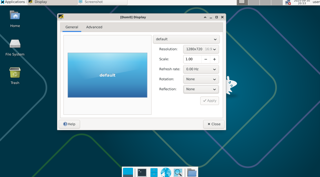

I needed to do that to have a good use of my Drawing Tablet. However, the qube that i ran all these commands, don’t display the full resolution of my monitor (1920x1080). In the display, i only have 1280x720 as maximum resolution. How can i fix that? I need to use fullscreen.
Didn’t solved.
Maybe i have to say that it only happens with this specific qube that i ran all these commands. When i create standalone VMs with ISO instead, this problem doesn’t happen.
