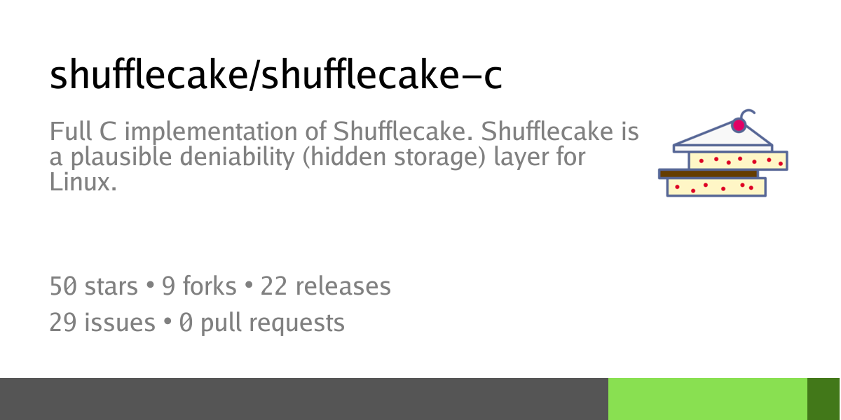

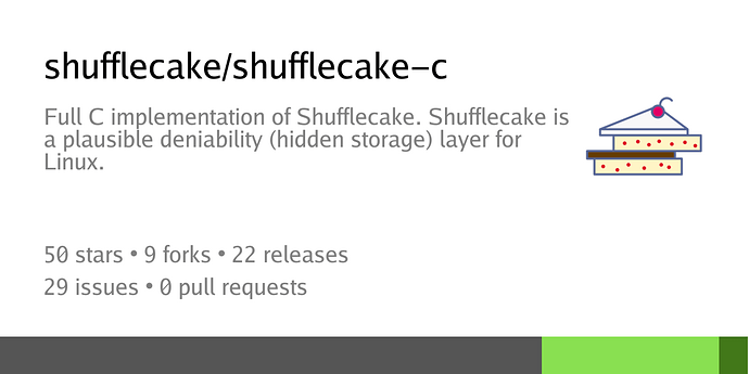

this is interesting
but no packages yet anywhere
I tried Shufflecake actually, from the codeberg. It kinda worked. It looks like a good idea.
You have layered hidden volumes from least to most secret. Each password unlocks a deeper layer.
I went back to a detached header for the same reasons I mentioned.
