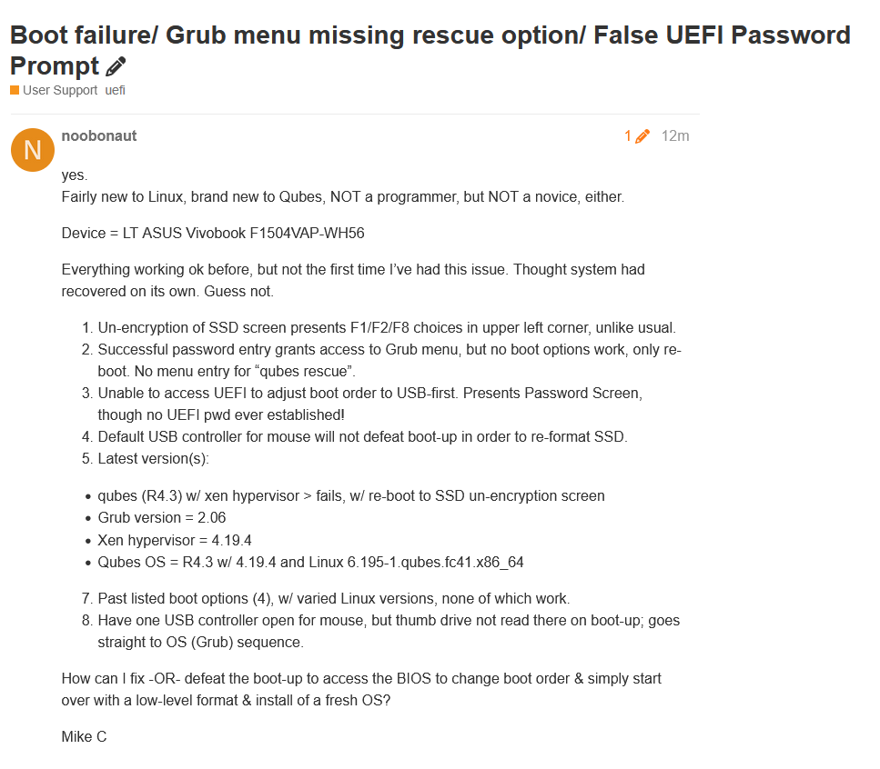

very late response. thank you for responding in April. I have a much bigger issue going on now. Don’t know why or if it’s related to an update.
Mike C
Hello Rian-
You were so kind to offer help before, maybe you have some direction for me now…
