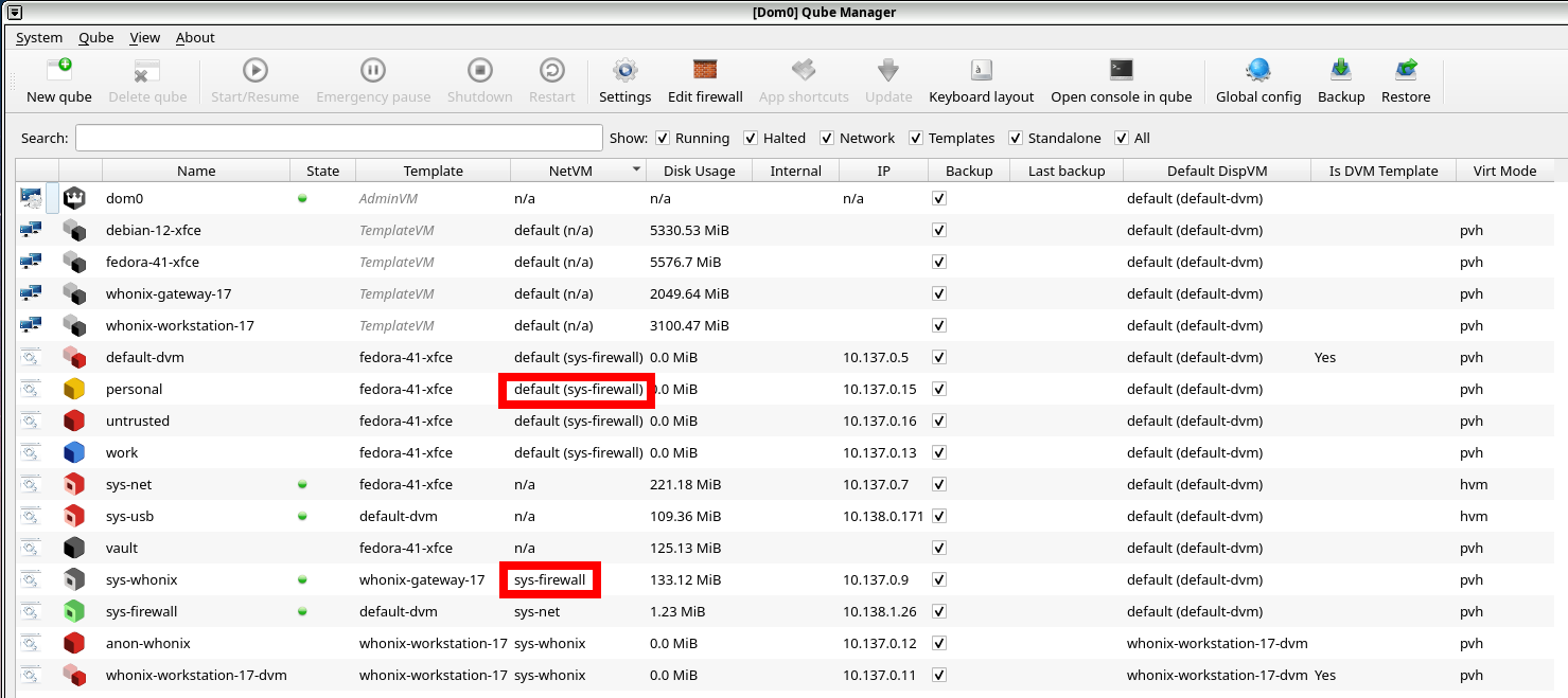

I have questions I tried the official documentation and I didn’t find any answer, please help out:
1- What’s the different between sys-firewall and default (sys-firewall)? as you can see in the pic below some qubes are connected to sys-firewall and other to default (sys-firewall)?
2- What’s the default-dvm and what happen if I deleted it?
3- Is there loop here, as you can see sys-firewall using default-dvm and default -dvm using default (sys-firewall) as NetVM and sys-firewall using sys-net as NetVM?
how are things work here
And I’m sorry for the newbie questions, I’m looking for an answer here
The “default” sets the current default net qube that is specified in “Qubes Global Config”. The difference here is that if you change the default net qube, all qubes set to that default will change to the new one, while in the other case it will stay on “sys-firewall” because it is specifically set to that value.
This is a disposable template, it is used to create new disposable qubes on the fly, which will be deleted once they are closed. If you delete it, you won’t be able to use this Qubes feature.
There is no loop. sys-firewall is a named disposable qube based on the default-dvm disposable template. This means that the state of sys-firewall is lost every time it is rebooted. It is completely separate from the original disposable template, and multiple of them can run at the same time from the same disposable template.
You would also not be able to delete it because currently other qubes have set dependencies against it. Trying to delete it will tell you, that you cannot until no other qubes depend on it.
p.s. Don’t delete it. You want it. Keep it where it is.
