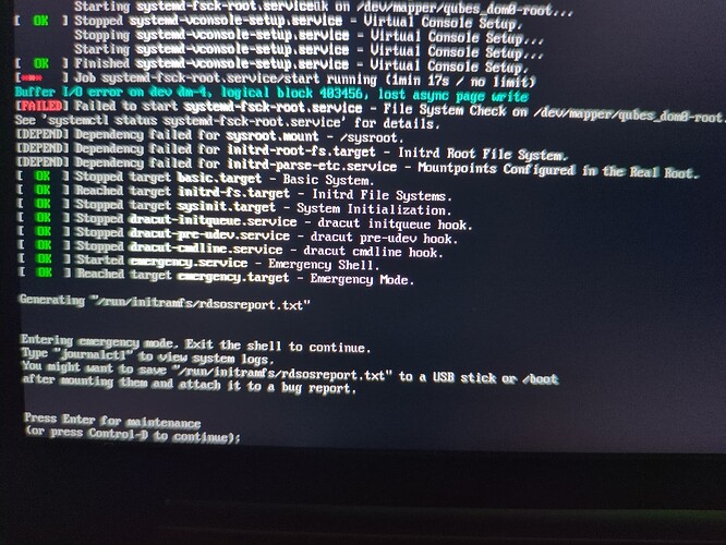

Houston, we have a problem. Critical error 4.3 (Buffer I/O Error on device: system-fsck-root.service failed)
Whoops. A critical error has occurred. This is most likely a bug in Qubes Manager
OSError: [Errno 5] I/O error ‘qvm-appmenus’ at line 1769 of file /usr/lib/python3.13/site-packages/qubesmanager/settings.py
Error appeared when creating kicksecure-18-dvm (maybe just a coincidence).
After that I could not press buttons, system froze. system does not start after reboot.
Qubes 4.3 with KDE. KDE installed from qubes doc guide. Yesterday KDE froze and I forcibly turned off the system with the power button. After that Qubes os started 2 times without problems.
Not an expert here, but “Buffer I/O error” looks like it is coming from a very low level of the kernel, where it is getting data from the disk. I am guessing a hardware problem with the disk, and not a Qubes problem.
Do you get always the same “logical block” number?
Bad cables often give random behaviour. For other bad hardware, it depends.
Are you able to “do what it says”, and press enter to get a simple prompt?
Then maybe dmesg | less will let you search for errors.
Do you have any reason to suspect your disk(s)?
We have no idea about your hardware, or other details.
If you can turn off/unplug, and open the PC, you can try to replug disks/cables.
If you have a live Linux system you can boot from USB or DVD, then you can look for problems using ```sudo smartctl -a /dev/<your hdd/sdd/nvm>
https://knowledge.broadcom.com/external/article/326323/failed-failed-to-start-file-system-check.html
Hi newqube :slight_smile:
If I read the image correctly, it suggests running
systemctl status systemd-fsck-root.service
and checking the output. Are you willing to share what it told you?
It looks like the link @shantyspruce shared, could be a path back to a working system … but check and compare the output you get, to see if you are in
  • the same
  • slightly different
  • completly different
situation.
:slight_smile:
Wow it worked! Thank you!
