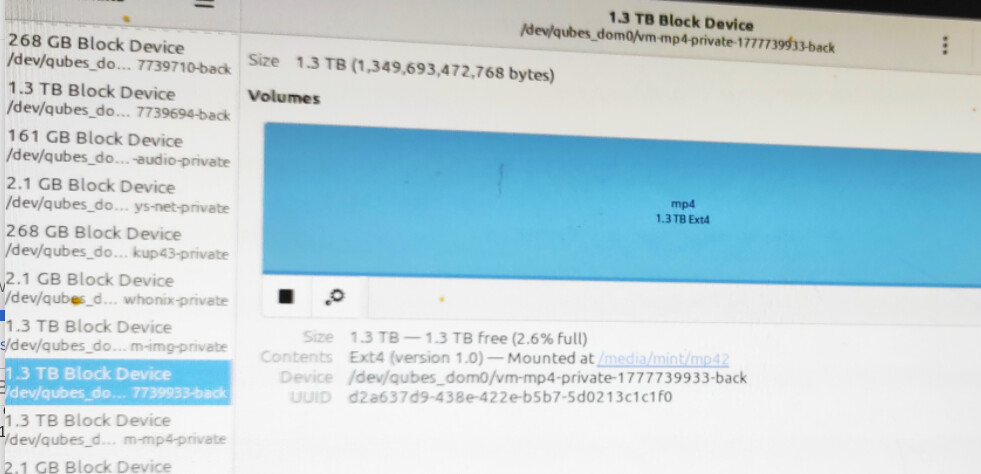

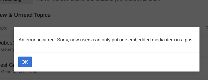

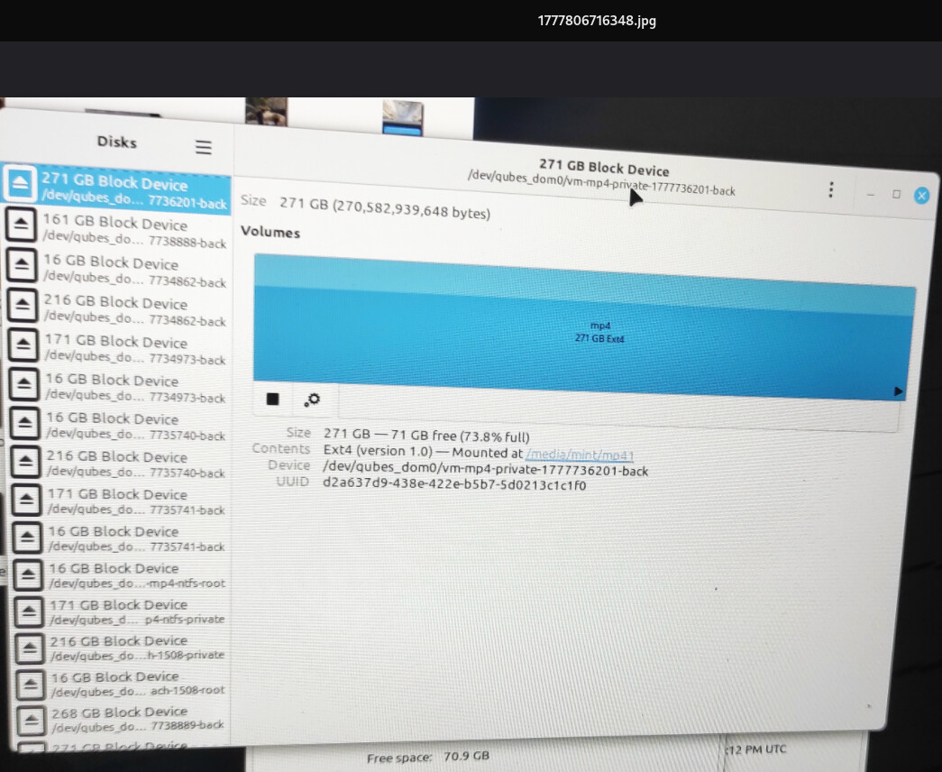

sorry that you did not understand me, I did not expressed myself well enough, here I re-explain myself better in 3 posts to reply to you @unman, as Qubes forum doesnt even let me upload 2 photos in one message because I am new and I am stucked…so I had to make a work around…:
What I did:
I created a dedicated Fedora AppVM called vm-mp4 to store media I was importing from other disks/partitions…
see the image 1 from the full size picture as this forum doesnt allow me to paste more than one media at the time=
As you can see on the image1, the partition with the data on was 73.8 percent full.*20gb of mp4 videos from my phone camera to be edited for next week…
From a separate Linux Mint live USB, I mounted the Qubes partition and the AppVM disk to use an image application called Pix) to copy media into the AppVM’s storage. The files where copied ended on the partition vm-mp4-private-17777736201-back ” — I believe these were stored on an extra partition Qubes created as a backup. as i got one without the ending in …6201-back
In Qubes settings I increased the AppVM’s VM vm-mp4-disk size (added extra space) and then rebooted into Linux Mint to add more the files.- the partition vm-mp4-private-17777736201-backfiles where gone, and the only vm-mp4 i had was ending in 9933-back was there. This is how the partition ended after the resize:2.6 percent full, none of my previous 200gb data there=
What happened?
The files that were previously visible in the “.back” partition disappeared after I increased the AppVM’s storage. That partition appears to have been resized and the data is no longer accessible.

I used Linux Mint live USB to mount and inspect partitions, is this a matter of recovering data from the partition from the image 2 or a matter to find the previous 71GB partition from the image 1?
I am sorry that you did not understand me, I did not expressed myself well enough, here I re-explain myself better in 3 posts to reply to you @unman, as Qubes forum doesnt even let me upload 2 photos in one message because I am new and I am stucked…so I had to make a work around…:
