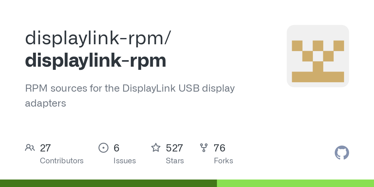

2. Came across the display link rpm github repo GitHub - displaylink-rpm/displaylink-rpm: RPM sources for the DisplayLink USB display adapters
and downloaded the rpm moved it to dom0 then chmod +x rpm file and sudo dnf install rpmfile
But it gave me an error
" Nothing provides dkms needed by display link, try to add --allowerasing to command line to replace conflicting packages"
so i did qubes-dom0-update dkms
then again tried to install the rpm.
3. Then rpm installed and i got an error with displaylink service, apparently the module evdi is not found, in module directory and i dont know how to install it.
Though i did try unraring the module file and just copying it to the said directory of modules which changed the error from module evid not found to execstartpre=/sbin/modprobe/ evdi failing.
