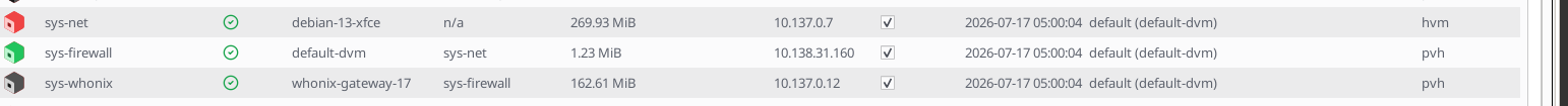

according to qubes manager default-dvm is
