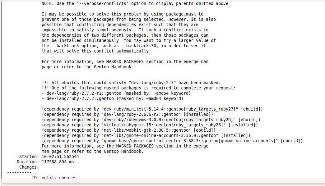

I installed the gentoo-xfce template on my qubes 4.1. I have to say that I am using gentoo just for a few days and don’'t know much about gentoo at the moment, but definitely are willing to learn it. The perfomance of the gentoo template and the firefox on x11 is amazing. None vm starts so fast and has such great internet perfomance for me as gentoo… But updating gentoo has some errors and tells me that some packages are masked by ~amd64 keyword. I google a while and tried some changes accepting keywords but cannot reach the goal
Does anybody know what is the correct way or emerge command to update it? Maybe I already did a big error and run emerge -udnav @world to update the complete template. This step took hours to compile and install everything again, but it is working. I already tried to install the gentoo template without -xfce, but that could not be installed correctly and I cannot delete the appmenue entry anymore. It will appear what ever I try. Here is a gentoo documentation about this problem, but unfortuntely it don’t work.

Updating the gentoo-xfce template emerge --sync runs now fine without any masked packages error or other, just the qubes updater says that that is not fully updated and if I run a update there then I will get several packages errors that cannot installed by the qubes-updater. emerge --sync says that not outdated packages were found on the system.
I even installed an compiled some useful apps like libreoffice and teams I need daily and it is working:) I now understand how to unmask a packages to /etc/portage/package.accept_keywords and the only problem I notice is the problem with the qubes updater. I will upload an screenshot later, which packages/ dependencies are my problem here .

next is the error I’ll get downloading the gentoo template. Niot the xfce-version. Here I even cannot delete that appmenu entry anymore and is another problem. The main topic here is about the gentoo-xfce and again nearly everything from that template is amazing ! thank you very much for that big and well done work!
