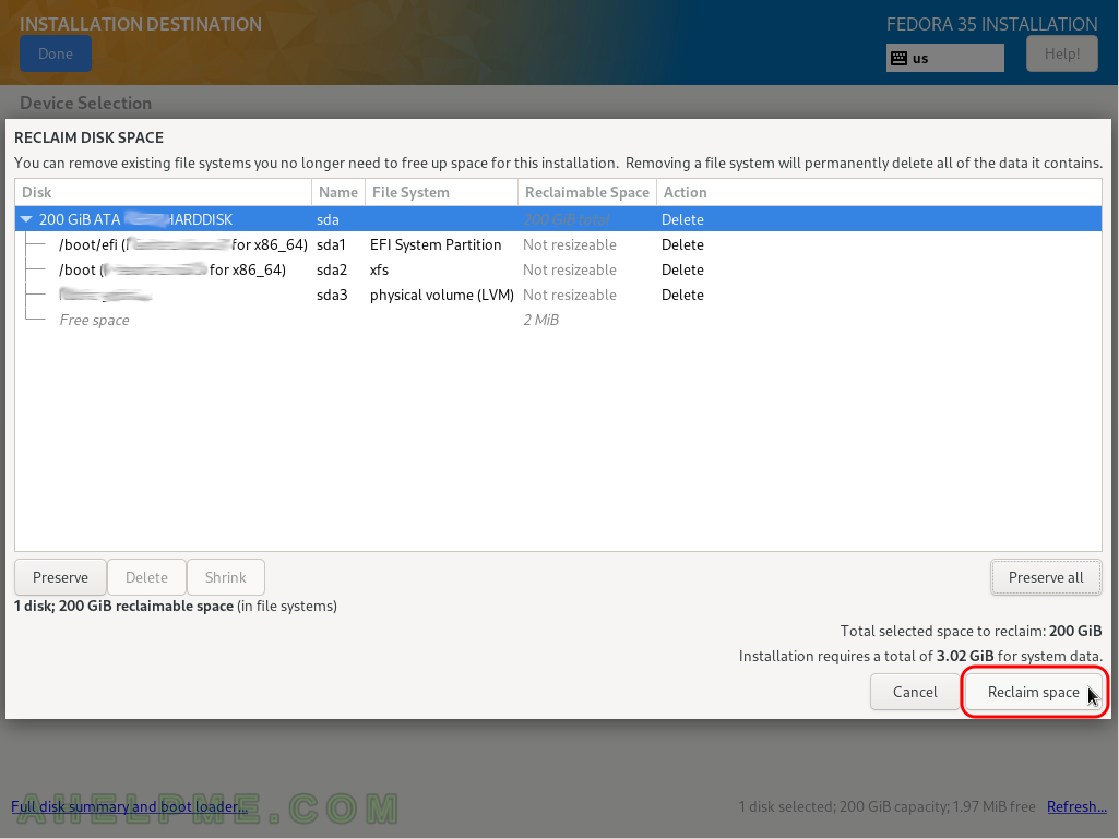

You press to reclaim all space?
I will test later, thank you!
