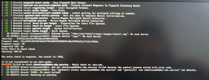

FATAL: CD check failed!
I’m installing the currently latest plain vanilla Qubes 4.2 from a USB drive. In the boot menu I selected “check install media and install Qubes” and the check step is failing with the attached message that only flashes for a fraction of a second and then leaves me on a black screen.
Installing Qubes from this USB drive generally works though and the ISO file passed the checksum test before copying it onto the drive.
I think it’s unlikely something is actually corrupted on the drive but I’d like to understand what is being tested and what the error message means.
