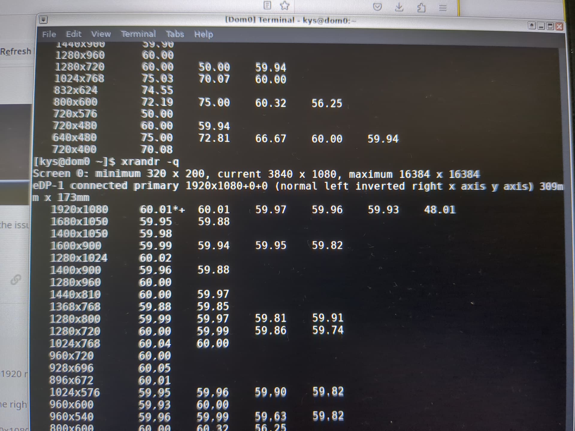

Xrandr shows the monitor
Display settings shows the monitor I can change resolution and everything
Screen stays black it says no video input.

They are set up like this. Why is it 1920x1080+1920 ? This might be the issue ? what does +1920 mean?
The “+1920” you see refers to the current monitor position (to the right of your primary monitor).
I can’t see the selected mode for the other monitor, is it also on 1920x1080?
Yep, this is the laptop screen
What is the current state of the external monitor, is it still showing “no video input”?
