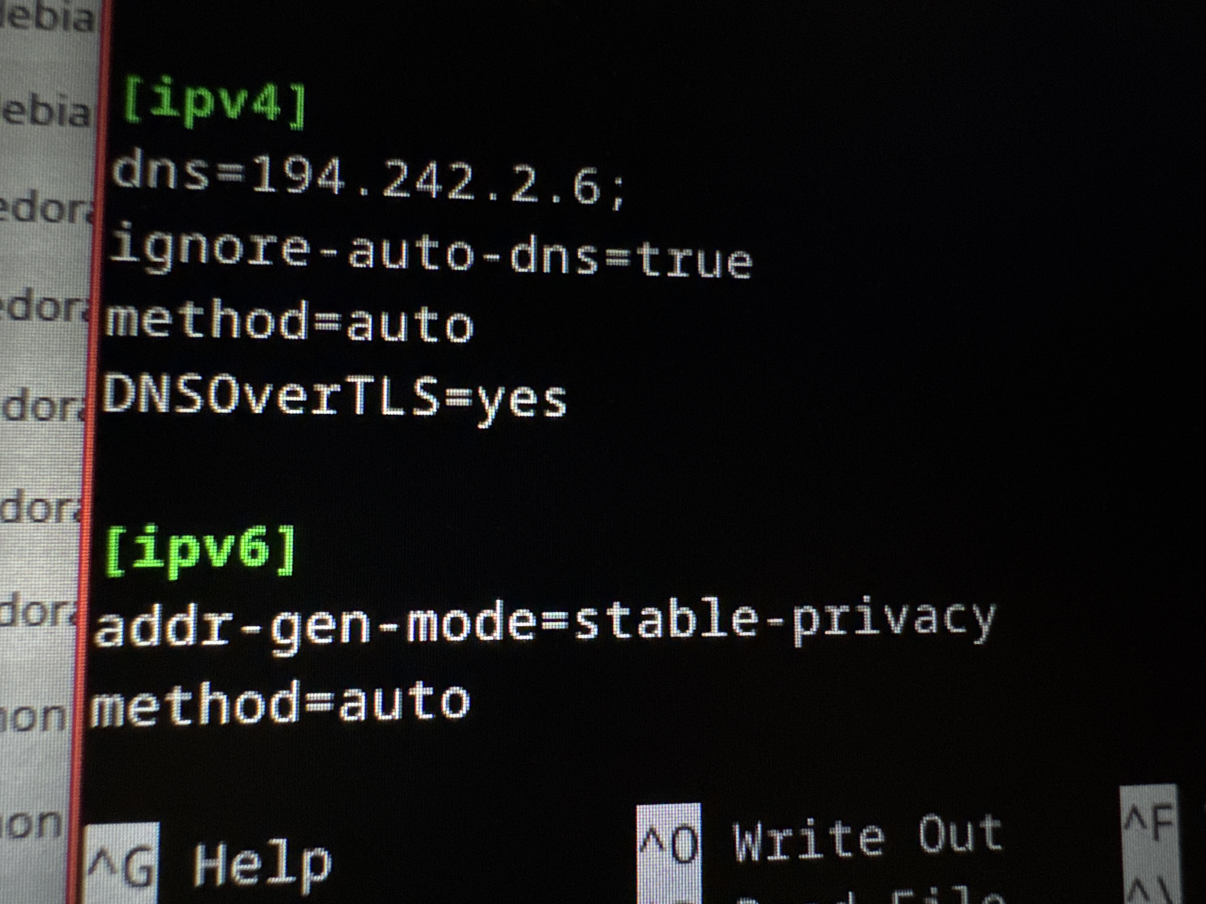

Noobie in Qubes and Linux. someone can help me explain a little bit how can i make DNS DOT or DOH (i would like to use Mullvad One) works?
i tryed to replace standard dns over port 53 with this one 194.242.2.6 but not work

How you try doing that? In which qube, sys-net?
Changed like normal dns from .nmconnection file into default-dvm (template) that sys-net use, to make the config persistent.
Than shutdown template and reboot sys-net.
So same procedure that i do when change default dns
Okay, what do you mean by “it does not work”?
See image in attachment.
I set dns and DNSOverTLS=yes
In the .nmconnection file theb reboot sys-net.
I see that from gui network manager get the right dns but i can not surfing.
Note: that dns is mullvad family one
Is network manager manager DNSoverTLS?
if yes some idea of what im doing wrong?
If not, my question of the topic, how do you manage dnsoverhttps and/or overTLS?
