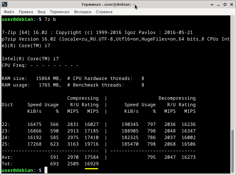

First, I installed a clean Debian on my computer and measured the speed.
It turned out to be 16929 MIPS:
Let’s take it as 100%.

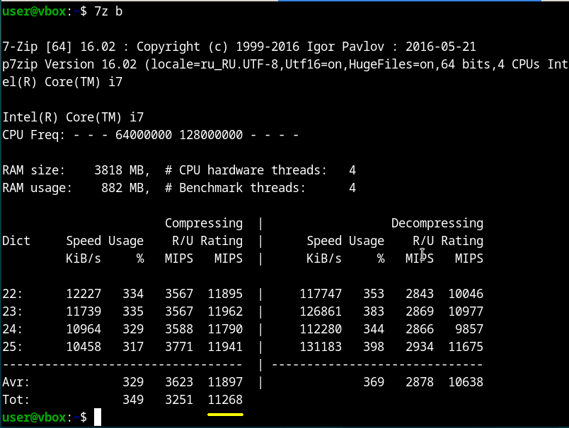

Then I installed VirtualBox, virtual Debian in it and measured the speed again.
It turned out to be 11268 MIPS:
VirtualBox, this is 67%, which is much less than the promised 95%.

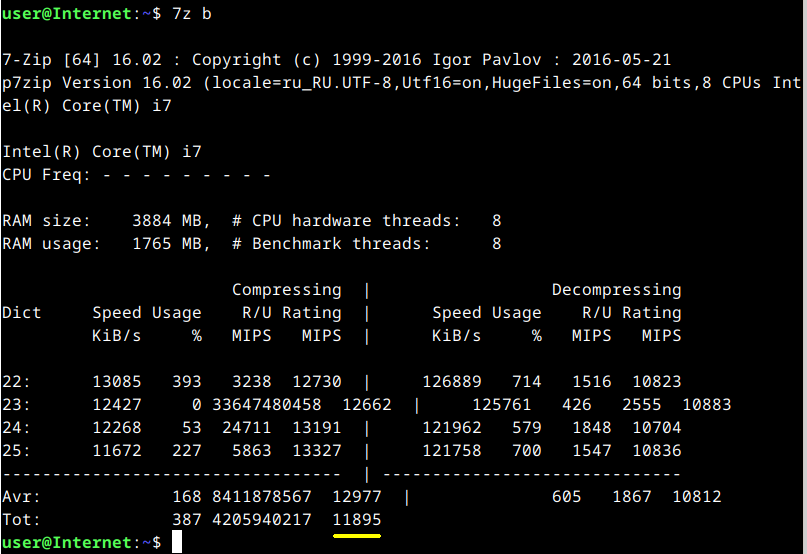

After that I installed Qubes on the same computer and measured the speed in Debian AppVM.
The speed was 11895 MIPS:
Xen on Qubes. this speed is 70% of the natural speed, i.e. 30% less than the expected speed of Xen.
This speed is 70% of the natural speed.
Why are Xen speeds in Qubes is it significantly lower than the expected 98% speed? :flushed:

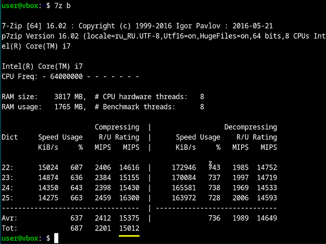

The previous Virtualbox test showed a speed of 67%, but only 4 cores were used here.

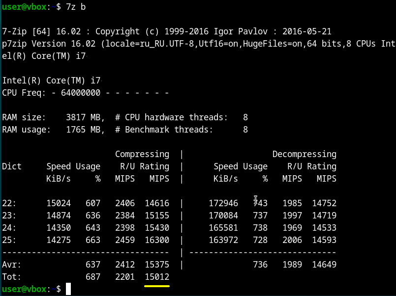

And now I’m using all 8 cores:
Now Speed VirtualBox = 15012 MIPS, this is 89%.
Total speed of:
VirtualBox = 89%
Xen in Qubes = 70%
So, Qubes &Xen shamefully lost even to VirtualBox?? :disappointed_relieved:

Did you enable smt?, the default Qubes OS settings is running Xen with smt=off.
No, I didn’t turn it on. Is the default value off wrong?
Off is the correct setting, but it is picked for security, not performance.
Disabling smt comes with a noticeable performance penalty, but it’s the only way to protect the system against transient execution vulnerabilities.
In artificial benchmarks, you could see 20% performance difference between smt on or off. If you are comparing Xen against a hypervisor that is using smt, you should enable it for Xen, if you want an apples to apples comparison.

If you want to compare like with like, then it will be necessary to manage the testing method a bit. It looks like the test scores assume 100% of resources are fully available.
Your VM is being told it has 8 vCPUs, but that doesn’t mean 7z is immediately getting 99.9% access to 8 physical CPU cores as it does in plain Debian. It is visible in the usage column… especially for the 8 and 16 Mb qubes tests which show a clear problem.
Maybe xentop can indicate what else is using the processors, but 0% CPU utilisation for a test is just weird. It is also not clear why the compression test can only use <6 cores, even on bare hardware. These look like artefacts of the test.
[Édit: I am assuming there is major contention for the CPUs… my experience of thrashing hardware is that contention is bad for performance, although I think that was trying multiple VMs running the Phoenix workbench]
Similarly, the RAM usage columns seem quite different between the tests. Qubes is telling the VM it has 4 GB, not all 16, like in Debian. By default it would not immediately allocate 4 GB, and any overhead of qmemman would (might?) directly affect a single run of the test.
At least, it is would be logical to:
  1. ensure that other VMs are shut down (but be careful if mouse and keyboard are on sys-usb, because you will lose control if you shut it down).
  2. Make sure your test VM has enough initial memory allocation, with balancing disabled.
  3. Run repeats, either by multiple runs of the single test, or using the argument of 7z.
  4. (and make sure smt is off in Debian)
Maybe there is more you could do to make the tests comparable. Even then, this test is not really representative of normal use - depending on what is normal for you. Ultimately, there will be some price to pay for all that Qubesy goodness, but it seems unlikely it would be 30% of 8 cores. It is more probable that you are seeing the effects of Qubes keeping resources where they are most useful, until a VM shows a need.
