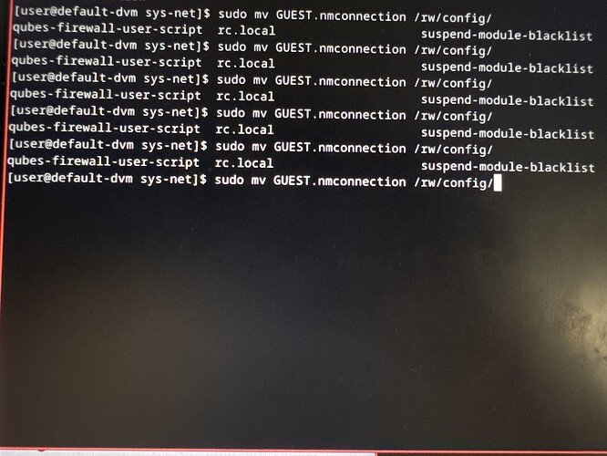

See image in attachment. I dont have folder NM-system-connections.
Some idea why?
Thanks
sudo mkdir /rw/config/NM-system-connections
Solved, with standard DNS all works fine. :slight_smile:
