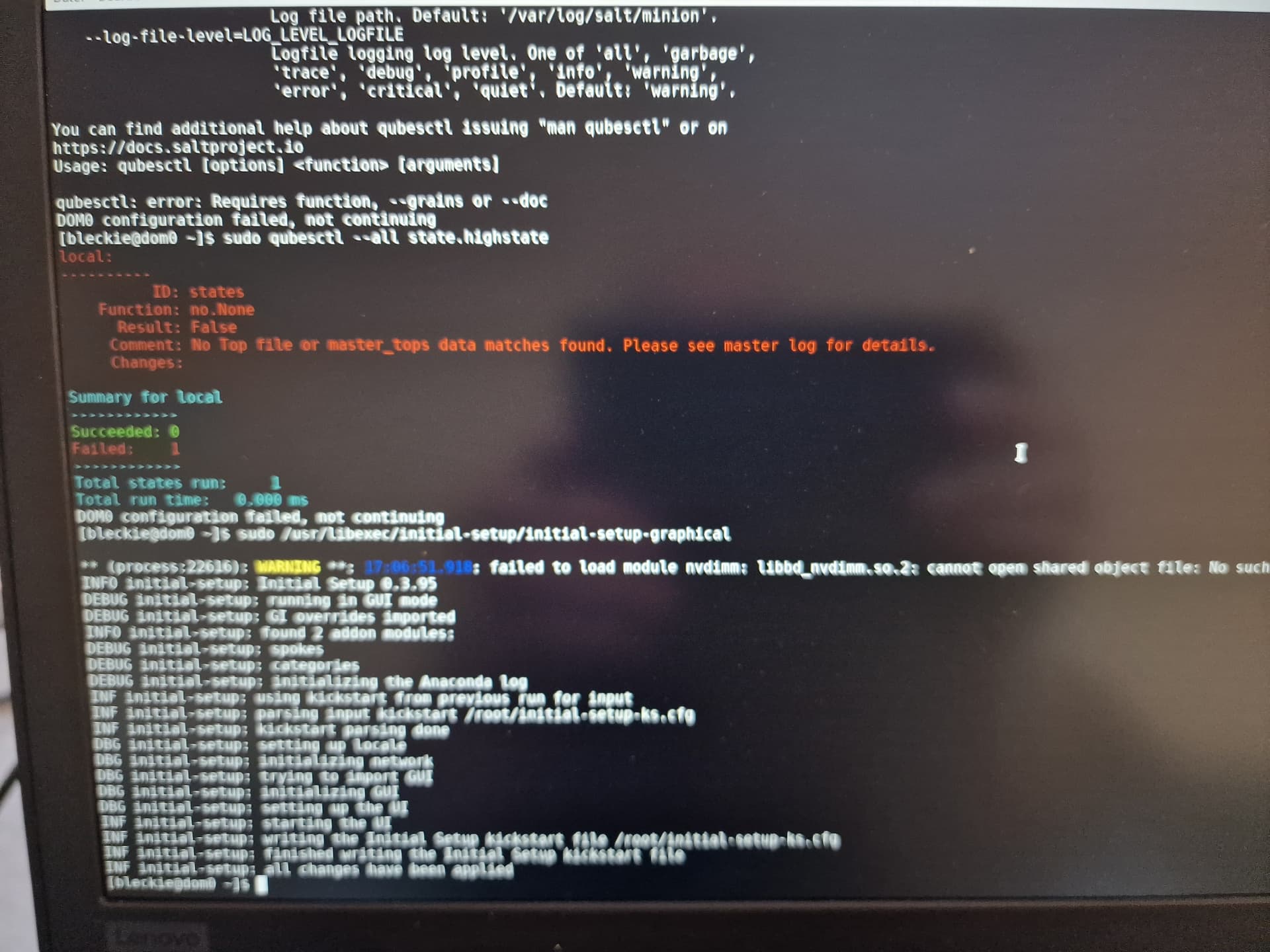

after another failed install, there was a message in the terminal:
failed to load module nvdimm. maybe this is the reason for the failure ?
I want to understand what went wrong first, before i am going to reinstall eventuallyâŚ
I just wanted to rule out some reasons ⌠![]()
At this point, I would do a second install - to see if the first one was a special case. I would also be looking to see if any errors would pop up this time around (eg: Does the âINITIAL SETUPâ start as it should after the first reboot? ⌠and does it produce any errors?).
You can check sys-net/sys-net-dm logs in Qube Manager to see why is it failing to start. And dom0 logs using journalctl -b command in dom0 terminal.

journalctl - b gives me thousand of linesâŚi cant interpret themâŚ
i had to wait 24 hours to be able to post gainâŚweired
Open Qubes Manager, right click on sys-net â Logs. Youâll see the logs and their location there.
Search for âsys-netâ keyword there and check the messages around the lines containing this keyword.
