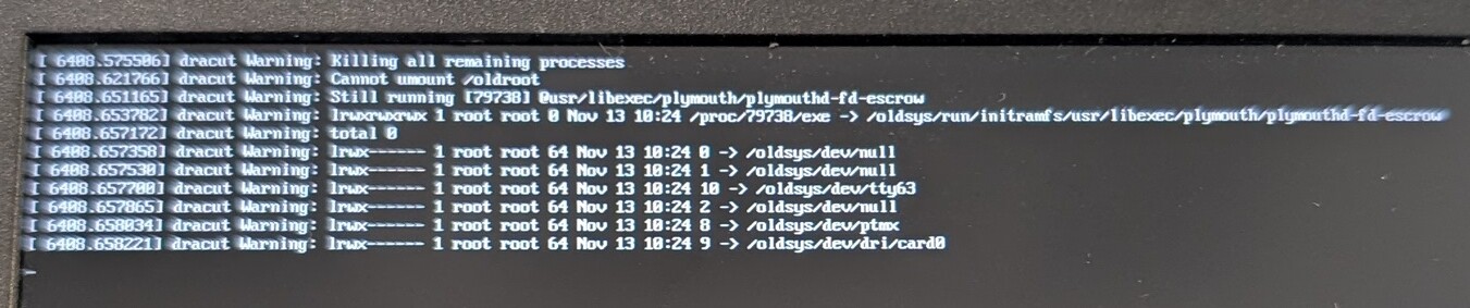

I’m having issues of the system not shutting down nor it rebooting. Version 4.2.4 It freezes up with black screen and few lines of warnings (attached screenshot). In rare occasions it does shutdown or reboots, but 90% of the time I have to shut it down by holding power button. Any solution on this?

I don’t know much about such things, but “plymouth” is the feature that gives a pretty gui during startup.
It would be interesting to try removing the rhgb item from the linux command line in the grub bootloader menu. This will give a simpler text interface during boot.

Per your suggestion I removed rhgb item and gave it a try. At the shutdown process it stops for a 45-60 seconds with warning saying “dracut Warning: Cannot umount /oldroot”, but it eventually shuts down after 45-60 seconds.

Per Cameron suggestion I also tried to shut down every single VM and leaving dom0. System shut down in this case without any delay.
If I shutdown all VM except system ones: sys-net and sys-usb, it shuts down same way as I remove rhgb at the boot (with a minute delay).
I wasn’t able to figure this out.
As solution, instead of shutting down 15-20 vm individually, I figured I could just shut down sys-net from qubes manager and it would ask me to shut down everything attached to it, what is basically all qubes except sys-usb, which I would shut down separately.
Now I upgraded to 4.3 and it appears this issue is gone with the upgrade.
