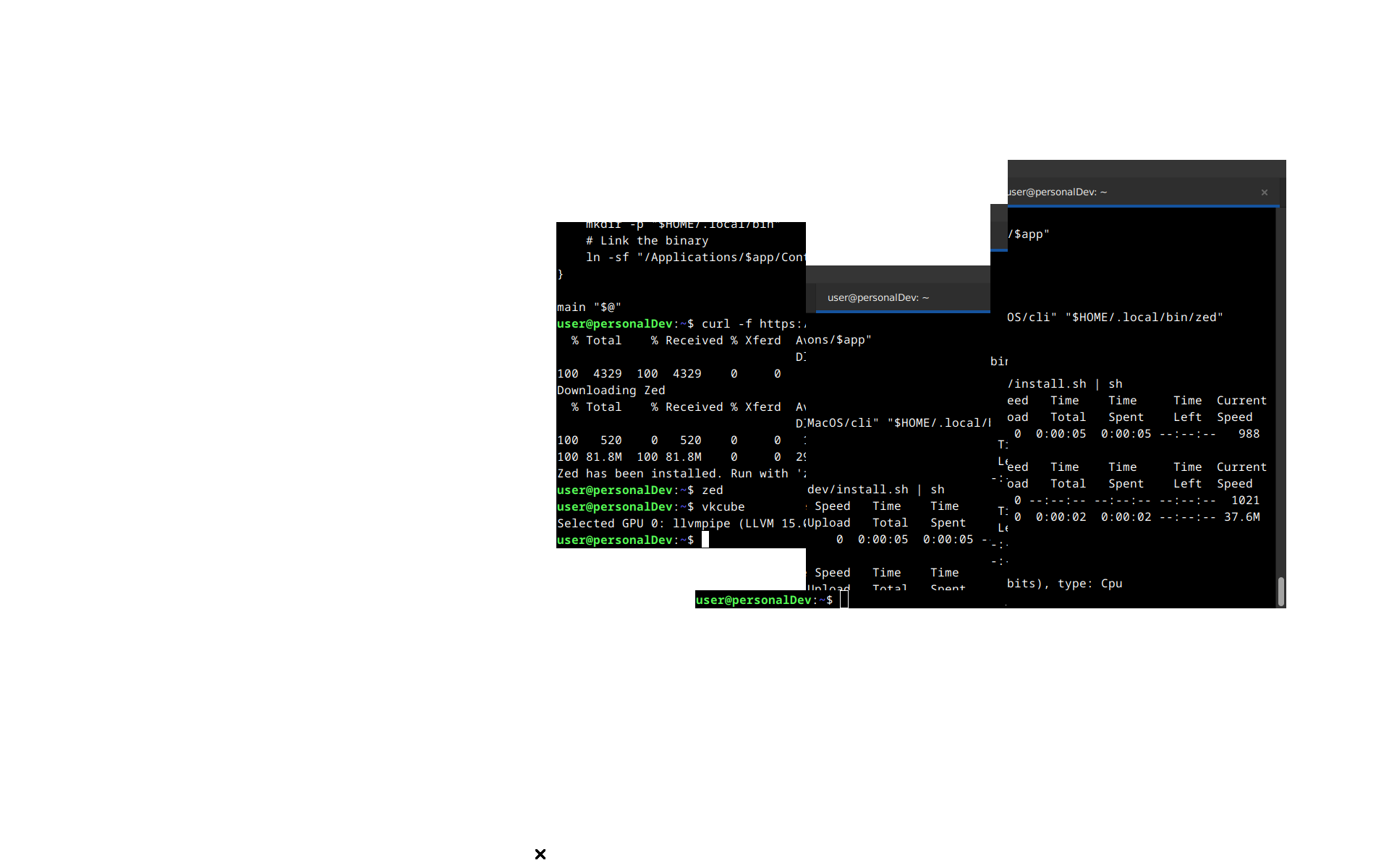

I gave the template temporary network access to download it which I know isnt recommended but I will use the proxy next time. I tried but i was missing the “export” command.
this is the output from the template
https_proxy=127.0.0.1:8082 curl -f https://zed.dev/install.sh > install.sh
 % Total    % Received % Xferd  Average Speed   Time    Time     Time  Current
                                Dload  Upload   Total   Spent    Left  Speed
100  4329  100  4329    0     0   2970      0  0:00:01  0:00:01 --:--:--  2969
this is the output from the AppVM
100  4329  100  4329    0     0   7720      0 --:--:-- --:--:-- --:--:--  7716

This made it open, but it looks like this. Going in the Zed documentation to see if i can fix it but any help or advice would be apprecitated.
You could copy the install into /etc/skel in the template, and it would be available
in any newly minted qubes, if that was required.
