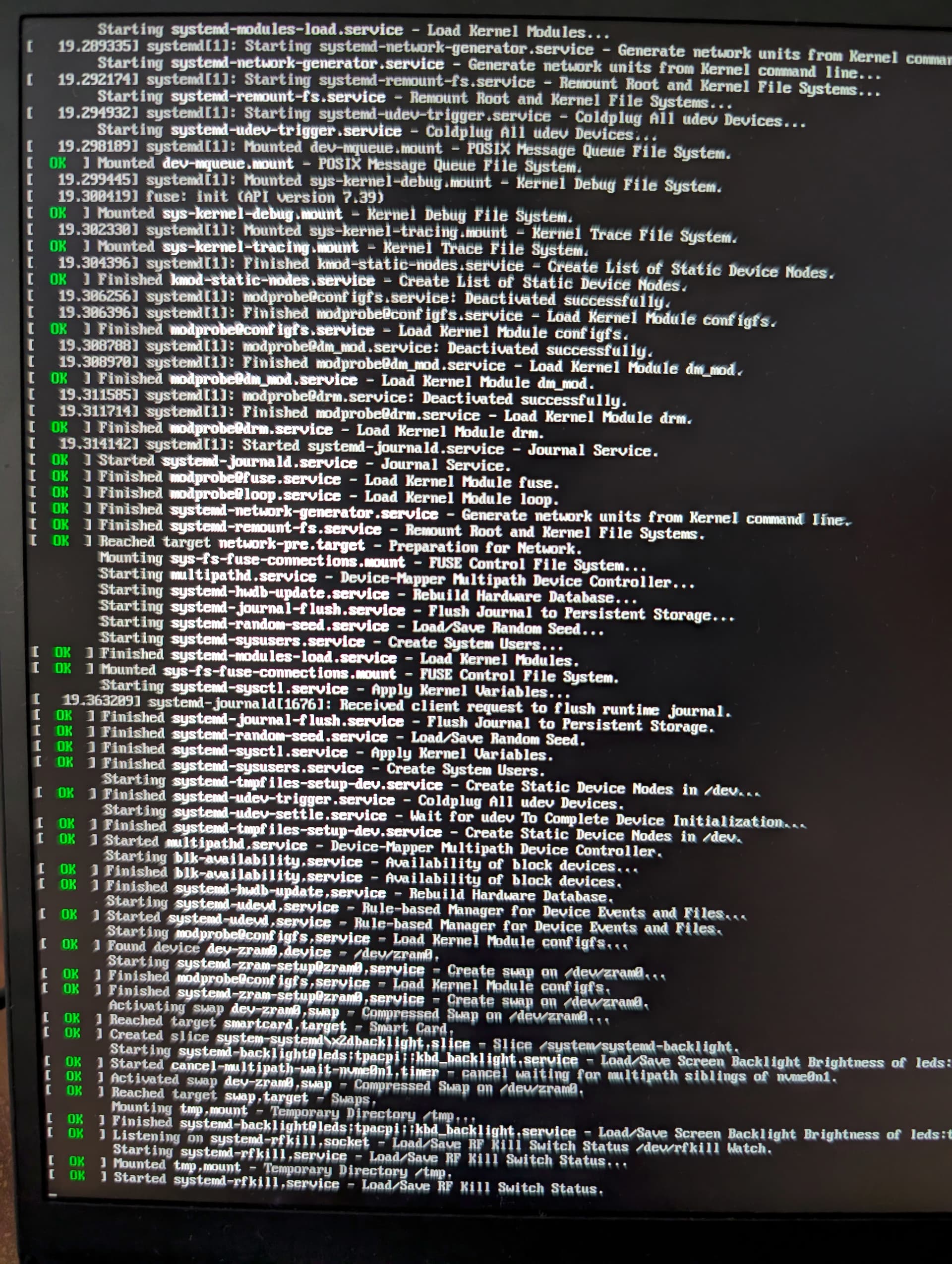

I’m trying to install QubesOS 4.2.4 from install-USB, but I have a problem. The boot process of install-USB always stops at the same place:
“Started systemd-rfkill.service - Load/Save RF Kill Switch Status.”
I tried to choose standard boot, boot with self-check and verbose boot… with same result. Boot process of install-USB is always stopped.

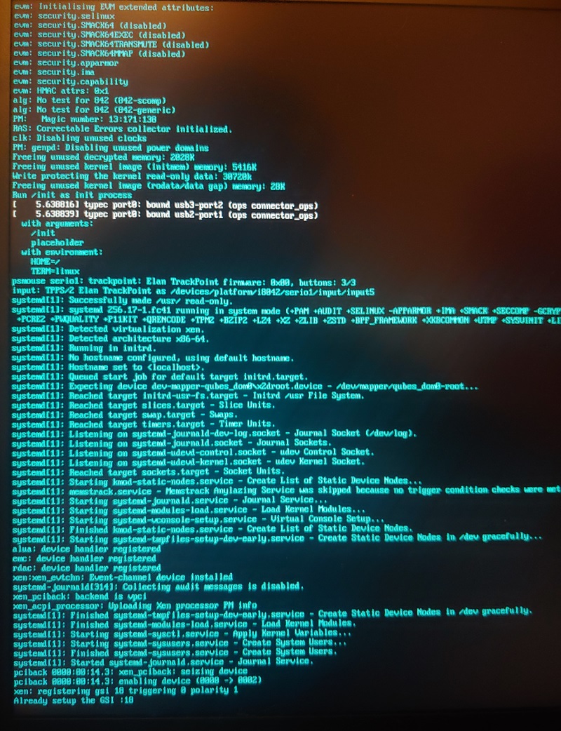

  1. I also try to used last boot option "Install Qubes OS R4.2.4 using kernel-latest (6.12.11-1.qubes.fc37). There boot process is auto-restarted after lines:
  1. …in progress… :slight_smile:
Hi juba
When the machine reboots automatically, you should be able to add:
console=vga vga=,keep loglvl=all guest_loglvl=all noreboot=1 earlyprintk=xen
to the Xen line in GRUB and get a chance to see what goes wrong. Note: The boot will be slloooowww :yawning_face:

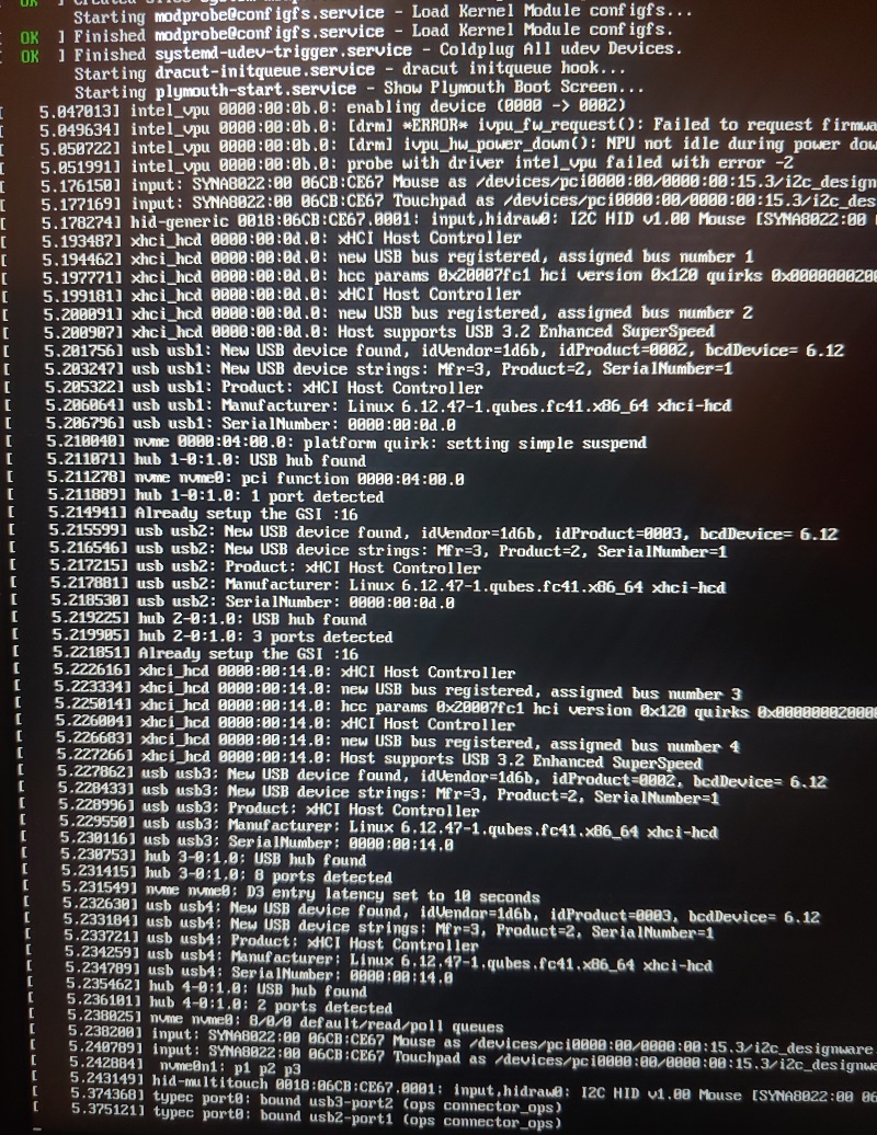

After every installation I also try to run all GRUB options. Results of default setup:
QubesOS-4.3.rc2:
Grub:Qubes, with Xen hypervisor:
[4.179539] dracut-cmdline[347]: Warning: USB in dom0 is not restricted. Consider rd.qubes.hide_all_usb or usbcore.authorized_default=0.
Grub:Advanced Options|Xen hypervisor version 4.19.3|Qubes with Xen 4.19.3 and Linux 6.12.47.1.qubes.fc41.x86_64
[4.469741] dracut-cmdline[346]: Warning: USB in dom0 is not restricted. Consider rd.qubes.hide_all_usb or usbcore.authorized_default=0.
Grub: Qubes, with Xen hypervisor (without grub “quiet” parameter):
Grub: Qubes, with Xen hypervisor (without grub “rhgb quiet” parameters):

But booting of installed QubesOS stop with same error:
dracut-cmdline[353]: Warning: USB in dom0 is not restricted. Consider rd.qubes.hide_all_usb or usbcore.authorized_default=0.
Same error for other grub-options (different is just line number):
Grub option "Qubes with Xen hypervisor" ...line 353 (default grub option)
Grub option "Advanced|Xen4.19.3, Linux 6.15.11.1" ...line 356
Grub option "Advanced|Xen4.19.3, Linux 6.12.47.1" ...line 342
