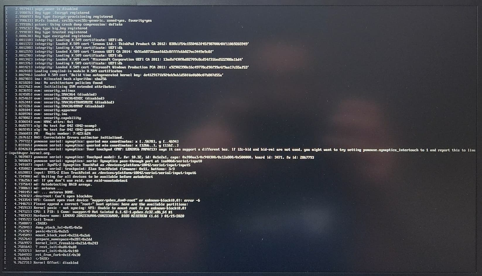

after an update, Qubes OS just bootloops. removing the quiet param reveals that it’s unable to mount the root device.
Though it stopped prompting for a disk encryption password.

here are some log message (typos due to google lens text ocr):
md: ... autorun DONE.
4.7495681 /dev/root: Can't open blockdev
4.7588751 VFS: Cannot open root device "mapper/qubes_dom0-root" or unknown-block(0,0): error -6
4.7521741 Please append a correct "root" boot option: here are the available partitions:
4.753488) Kernel panic not syncing: VFS: Unable to mount root fs on unknown-block(0,0)
4.7547741 CPU: 1 PID: 1 Conn: upper Not tainted 6.1.42-1.qubes.fc2.6 f
