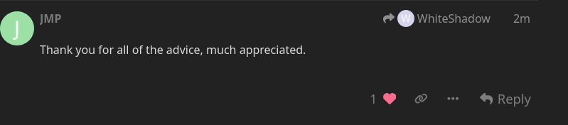

Thank you for all of the advice, much appreciated.

Regrading all your last comments, please use heart button to say thanks instead :slightly_smiling_face:
