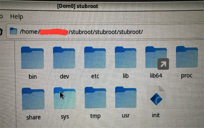

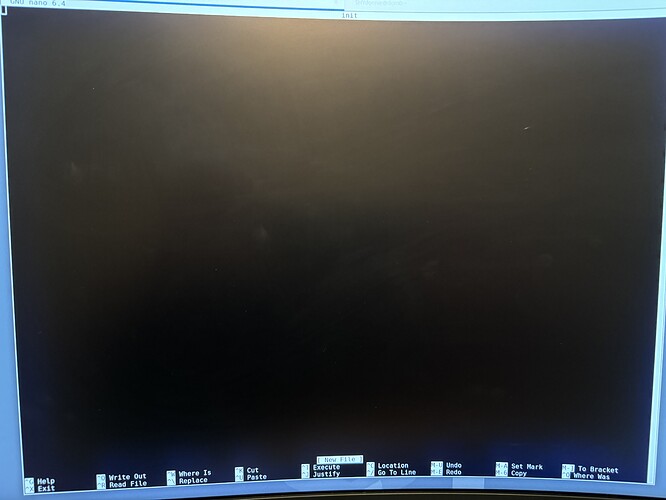

The error means you messed up either the file “/usr/share/qubes/templates/libvirt/xen.xml” in dom0
or you incorrectly patched the stubdom init file.
So check the guide and the content of thoses files.
And if you need help, paste the content of thoses files
