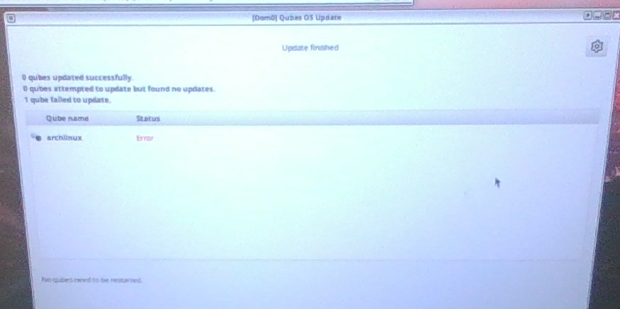

I installed Arch Linux qube and i trying to update. I encountered problem below.
Updating archlinux
Progress reporting not supported.
Refreshing package info
:: Synchronizing package databases…
error: restricting filesystem access failed because Landlock is not supported by the kernel!
error: switching to sandbox user ‘alpm’ failed!
error: failed to synchronize all databases (failed to retrieve some files)
Installed packages:
None
Updated packages:
None
Removed packages:
None

This showed on Qubes OS Update. It does not said which version of Arch.
