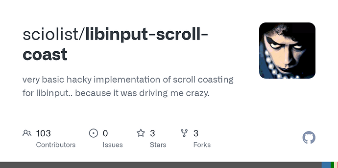

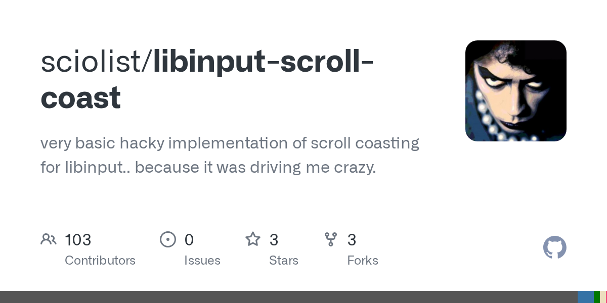

On the other hand, the inertia of the scroll can be applied in libinput by using this 2 repos:
But I’m not working on these until the High Resolution Scrolling is implemented, because combining scroll coasting with a discrete scroll (3 lines per scroll unit) can be even a worse UX.
