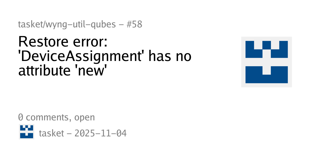

I don’t know if this can work under Qubes 4.3 alpha. It may be that version still has the 4.2 device interface, in which case you could try forcing wyng-util-qubes into using the old function. On line 323 changing oldqver = ctx.get_qubes_version()[:2] < (4,3) to this oldqver = True will do it.
Otherwise, you can try an updated version of the util in the testing branch here. It will skip the device assignment if an error occurs. This will leave sys-net with no devices and a “backup-restore-in-progress” tag that prevents it from starting; you can manually assign the net devices on the VM’s Devices tab and remove the tag this way in dom0: qvm-tags sys-net del backup-restore-in-progress
I also created an issue for this:
