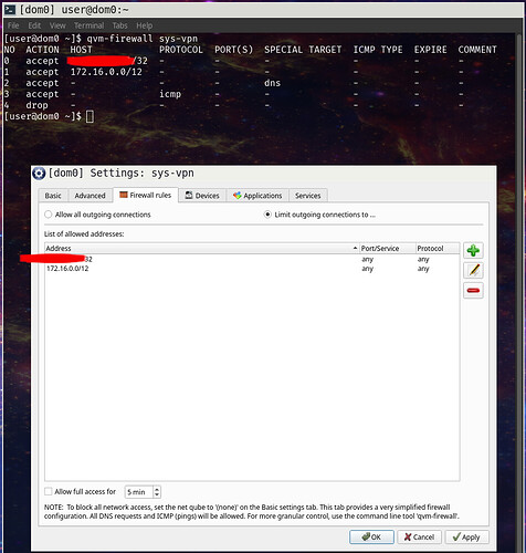

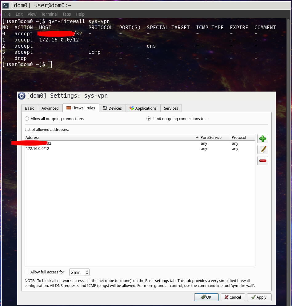

Did you use the firewall tab in the qube settings or qvm-firewall command? Could you try a ping? Does ping work from sys-firewall to your LAN?
I used the Firewall Setting table in the Qubes Settings Manager. But for good measure, you can also see the firewall settings here:
Also, I am just trying to reach my router gateway at 172.22.132.1. It responds to ICMP traffic.
