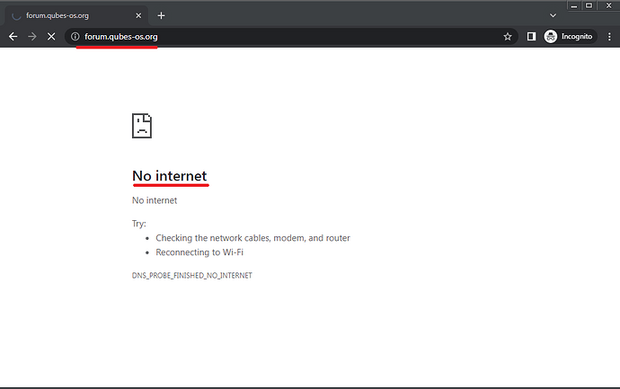

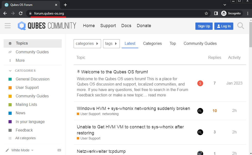

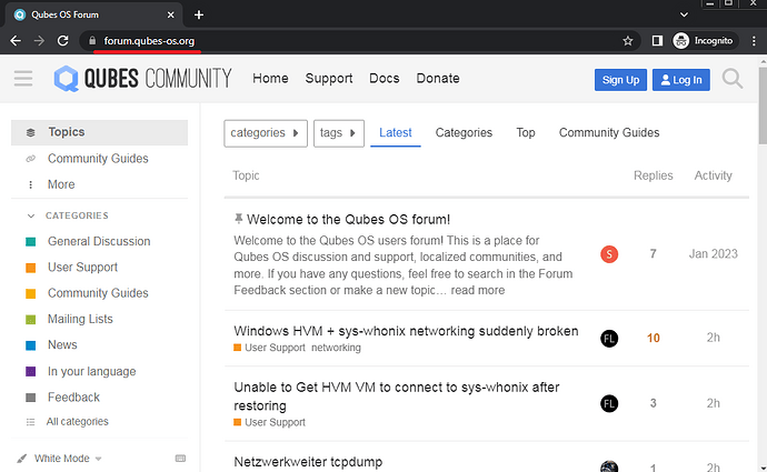

@unman
@unman The situation is as follows:
sys-whonix → windows HVM
sys-vpn → Windows HVM
sys-whonix → sys-vpn → Windows HVM
I’ve raised an issue - #9990
