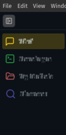

This is currently happening in qubes. While typing, my system will jump from one window to another. For example, I was using the terminal for sys-whonix and the system jumped to my Tor browser window and suddenly I was tying in that.
Also, while typing in this, my cursor (in this text field) jumps over to similar topics.
I am also having this problem while using my other operating system, which is a linux system on the same machine that uses gnome. It happens a lot, sometimes with random programs opening up that I have not even requested to open.

It’s like a hidden mouse is being moved around and occasionally selecting part of the screen.
The only thing that doesn’t fit with this is that programs are opening up on their own too. The problems happen both in Qubes and the other gnome-based linux I have on the system, but programs have not opened on their own in Qubes.

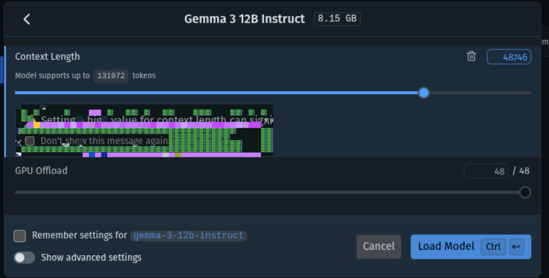

My money would still be on a hardware issue. Maybe it’s not the touchscreen itself that’s broken but the mainboard? Which could affect touchscreen or keyboard input.
In general, to me this kind of thing always feels like an implausible mismatch between what would be very high skilled intrusions affecting dom0, or firmware, … but looking undisciplined and extremely noisy, spamming key presses and mouse movements and all that.
Also on a statistical level the base rate of being hacked individually is low enough, and computer hardware and the software stack behaving oddly in some unspecific way is so common it’s a miracle anything ever works at all - that if the latter is used to diagnose the former, this test must have a false positive rate close to 100%.
But I’m not a hardware or malware or incident recovery expert. I’m just saying in your situation, I’d probably go ugh, there’s another expensive paperweight. Now if the same thing happened again (especially with a different notebook model), and faulty electrical wiring in my home frying my electronics one after the other had been ruled out, it would start to look interesting.

When loading models and using a large amount of RAM, I am now getting unusual graphics errors.
This is sometimes affecting the fonts and shading of windows too.
I continue to not know whether this is likely a firmware hack issue, motherboard/chipset damage issue, an OS or bios issue, and whether this represents a security risk.
This happened when I used a large amount of the RAM, over half of the RAM on this machine. When I use more than that, the machine just crashes.
I have also seen unusual font disturbances, where some of the letters are missing, in other programs. Although this is occurring in the non-Qubes OS, I am also having problems in Qubes OS and don’t know what to make of this problem.
