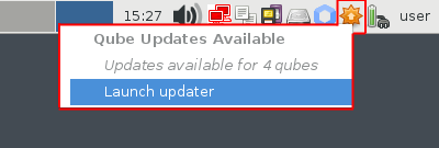

I used the system update tray and ticked the various vm’s and templates that needed updating… After that It told me that I was unable to update through dom0 and it would use a template instead. After that it appeared to go through the proper process of updating and I checked the automatic logs that it produced and everything seemed all right but I am not an expert in understanding the output. I did update the same way of at least four occasions over the last six months and everything seemed to be fine… I’m of course wondering if I have been hacked here for this to happen or is that just plain paranoia at this stage?

Do you mean you used Qubes Update tool(which appears in notification area) ?
Yes, that is correct!
Looks like you did everything right. This is the recommended way of updating Qubes OS. What do you mean by “I was unable to update through dom0”?

I cannot remember whether it came up on the updater app itself or a separate warning screen but it said something like “Cannot update using Dom0, will update using Banking VM” choices were Yes/Cancel. Thinking about it this was probably a separate warning screen…
This question looks really strange to me, never seen anything like that. Every window in Qubes has a colorful border showing a VM color. I wonder, which VM was asking this question. You should always look at the borders to see if you can trust the question. Also, you can take screenshots with PrtScr and save them in dom0, just in case, every time you see something suspicious…
