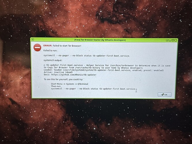

Tor Browser fails to start only in StandaloneVM (not TemplateVM), showing:
Failed to start Tor Browser
Failed to run:
systemctl –no-pager –no-block status tb-updater-first-boot.service
Active: inactive (dead)
This happens even though Tor Browser is correctly downloaded and verified in whonix-workstation-18 TemplateVM.

Actual behavior
  • Tor Browser fails to start in StandaloneVM
  • Error references tb-updater-first-boot.service
  • Service is inactive (dead), but Tor Browser refuses to start
  • No way to fix this inside StandaloneVM (no sudo, by design in Whonix 18)

In StandaloneVM:
