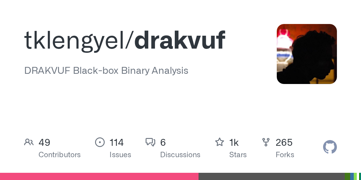

However there are more specialized solutions like DRAKVUF
https://drakvuf.com/

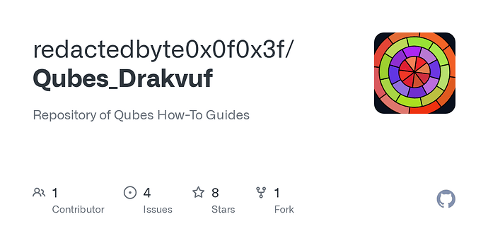

And somebody already made a ‘fusion’ of these:
There are some issues with this approach. First some vm signs can’t be get rid off even if you will manage to make the vm very convincing looking bare metal install. Namely manipulation of raw packets has big issues. I don’t know if it’s possible to solve them. Secondly if you really care about safety and if you want to use it on the same machine you do your banking, taxes and other real life activities you should look into nested virtualization. It’s way harder for malware to break out of vm if it is inside another vm which is virtualized differently. For example you may have windows 10 inside bhyve hypervisor running on freebsd which is inside xen hypervisor running linux. But the performance will be extremely bad
