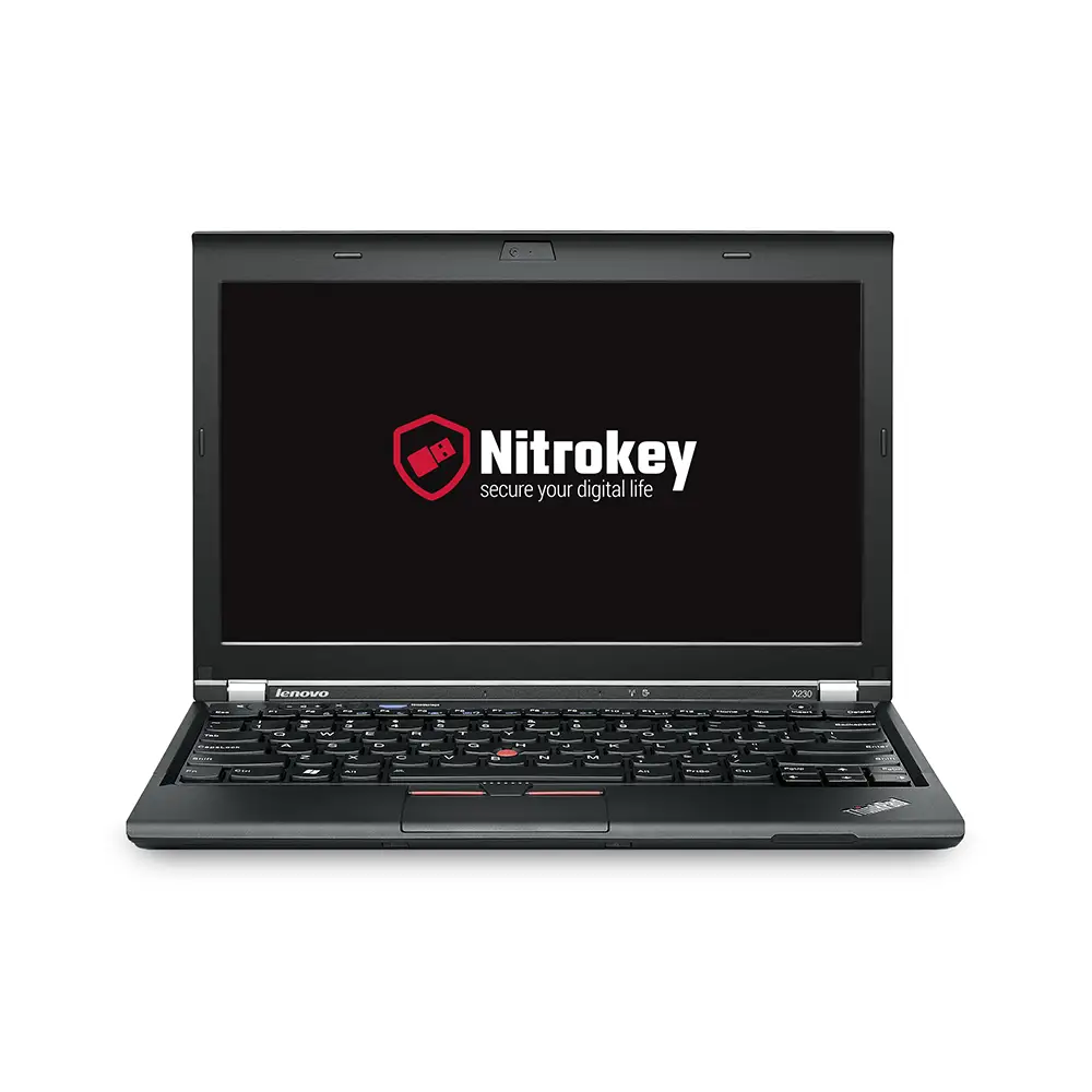

After I bricked my X230, I got lucky & bought a maxed out Nitropad X230 for $200 w/ HEADS, so I have no reason to try flashing anything again.

Wow how did you find it for such good price also how do you verify everything is legit? I still dont get the difference between Coreboot Heads, Coreboot Skulls… etc etc in a way that is easy to understand.
You can always get lucky if you spend some time just checking marketplaces everyday. I also managed to buy a brand new System76 Darter Pro 8 for 400$ cause I was always on the lookout for System76 laptops.
