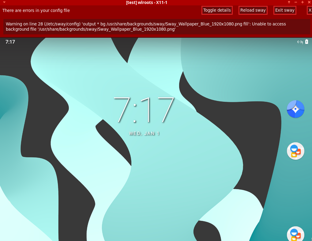

Hi I am sometimes getting the following message when installing waydroid:
I have not found out what triggers this. In some installs the SWAY background is visible and in some installs it shows this message.
