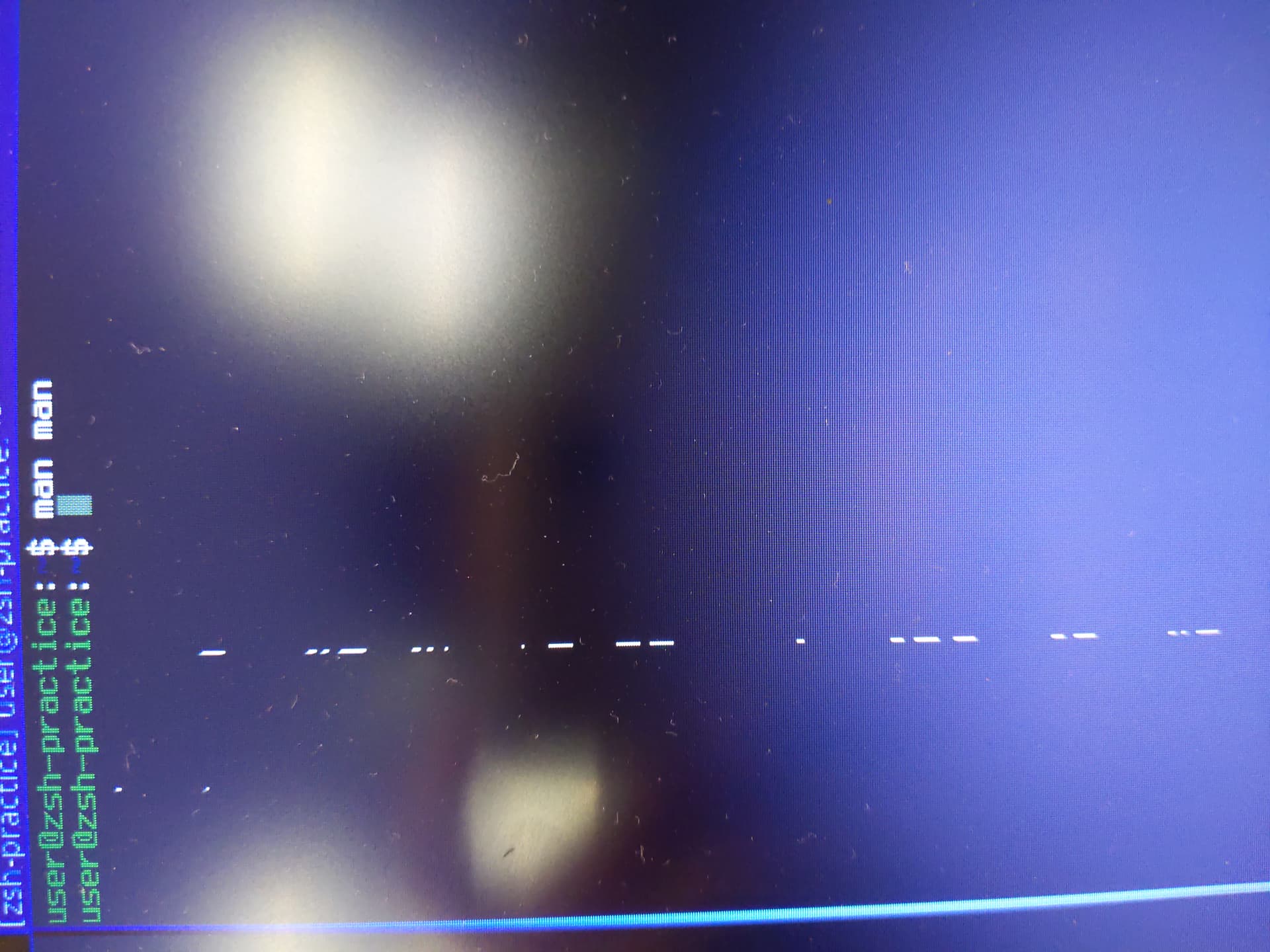

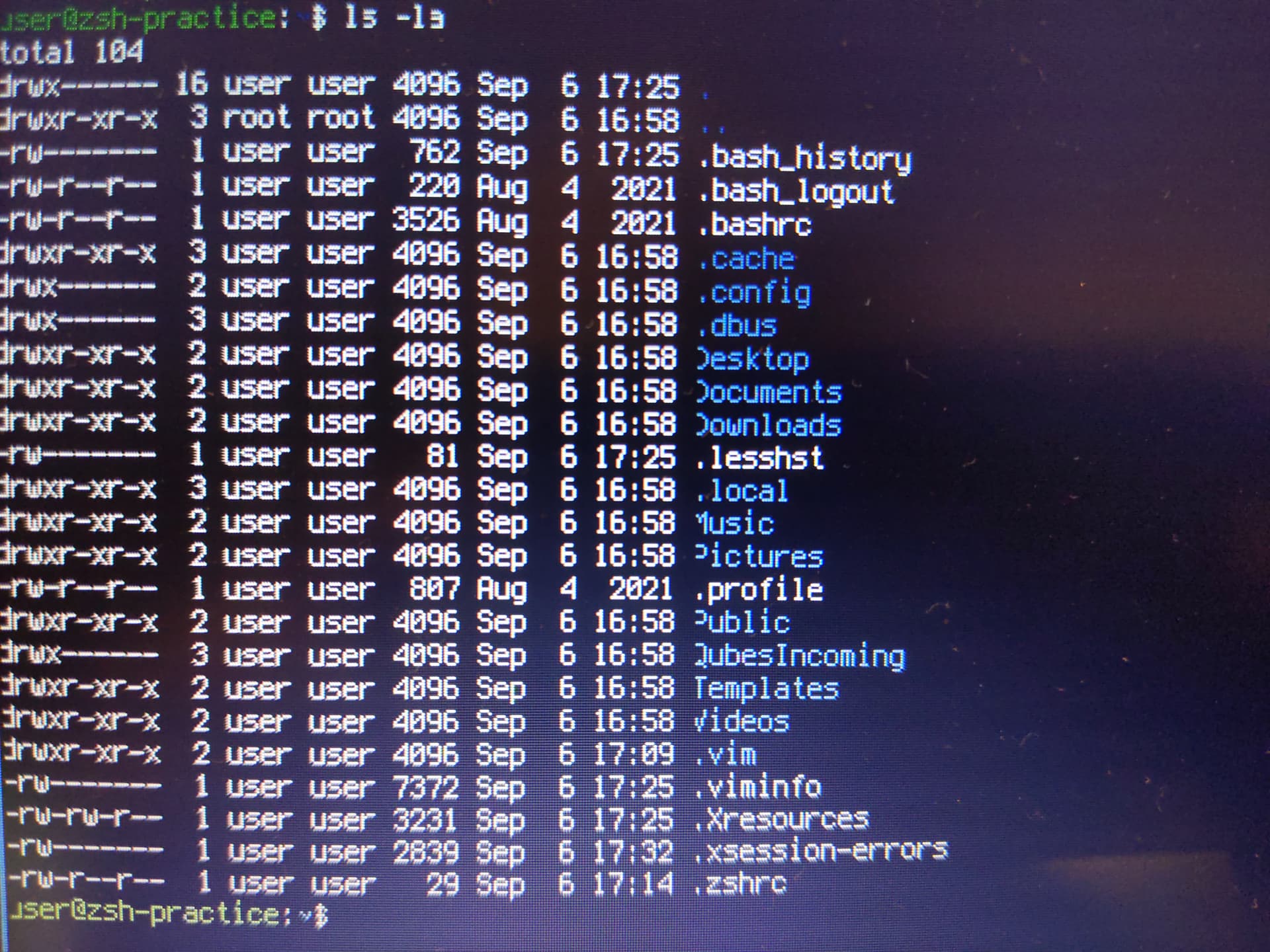

Here are the pictures of the artefacts:
You can see that there are rendering (?) bugs with the fonts. That is, the file name fonts are not fully displayed, they seem to cut at the left-most side.
