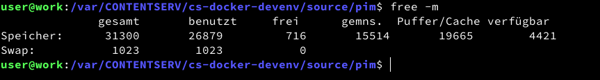

I have decided to disable memory balancing on some of the HVMs, as the assigned VRAM seems to be calculated based on the initial memory (as you also found) and does not grow when the memory assigned to the VM grows.
