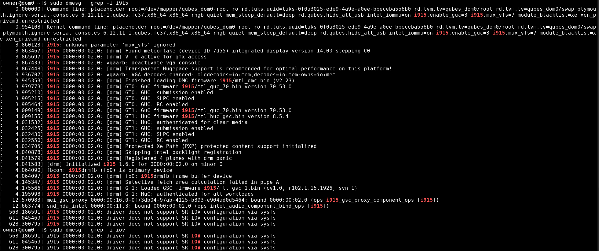

Hi,
tried your guide but get stuck at step 10:
Cannot activate virtual gpus. Assuming that the module has not loaded correctly because the output in the first screenshot. Not sure how to proceed from here, any idea?
Thanks!

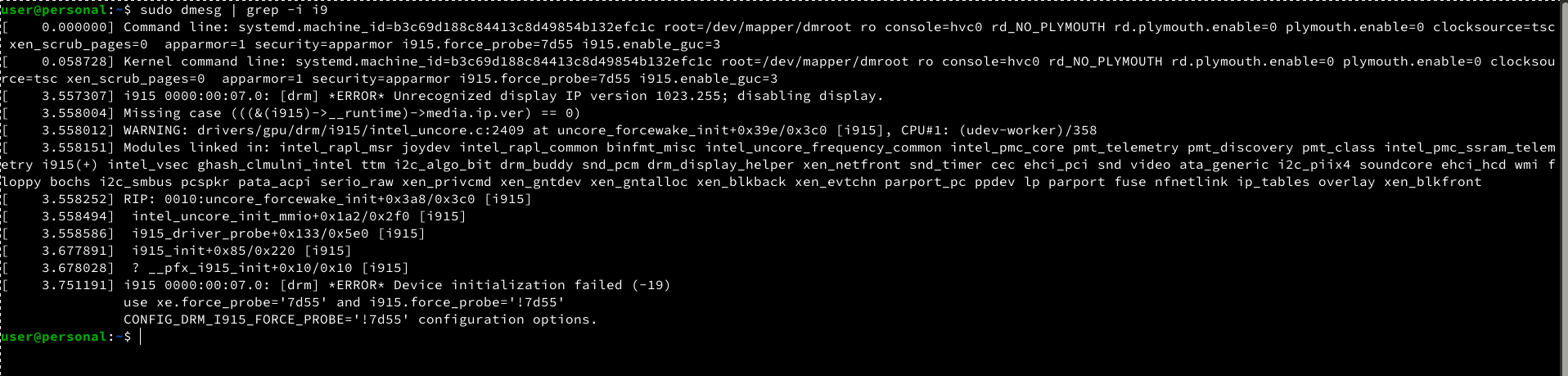

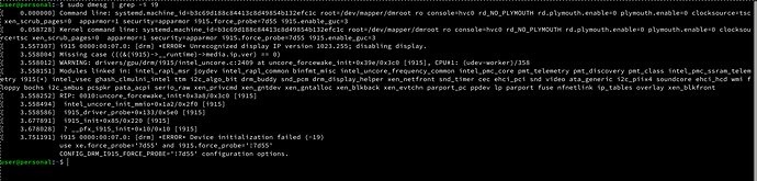

So, I have done all steps but am not able to get the driver to load the GPU in my VM:
I have checked for the kernel versions in dom0 and vm, both same: The thing is that I had to choose the corresponding kernel version for VM directly, as “use kernel provided by qube” delivered a different one (older). Other than that I think I have done everything in the guide. Have you seen the error shown in the screenshot? Is the module nod loaded?
Thanks for your support!
Uh, looks like the i915 driver didn’t load for you. You can try if running the Xe variant works using this xe.max_vfs=7 xe.force_probe=${device_id} module_blacklist=i915 for GRUB_CMDLINE_LINUX_DEFAULT.
Despite that, did you check if you downloaded the correct version for your Kernel?
The driver works correctly in dom0, I am able to create virtual gpus and assign them to guests. Therefore I think it is correct :slight_smile:
Will try your suggestion, thanks!
Ah, wait, your suggestion is related to dom0, correct? There everything works fine. My guest is giving me this error when it starts and is not able to use the assigned vgpu.
So then what i would check is, if your VM uses the Kernel with the modified driver, so the same as dom0.
Otherwise, you could try using the Xe driver there, you get the CMDLINE as an solutionhint in the last block ouf the output you posted. Also check if you have firmware-intel-graphics installed in your VM.
If this doesn’t work I would check what the other Guides for general GPU Passtrough mention for debuging steps.
I checked for “firmware-intel-graphics”, it is installed. Also tried the “xe” version, does not work.
What kernel are you currently using in dom0 and VM? If you updated your system recently, it should be the same as mine. Also, are you using the master of the i915 driver or the specific tag matching your kernel version?
What is the best way to check if the kernel has the modified module available in VM?
Thanks!
Ok, so I decided to give it a try and installed the kernel module on my guests template, and with that, the gpu is picked up correctly. Which means that using the same kernel as dom0 is not enough for it to work. This is also what other threads state, that the module must be there on the quest. Not sure why it works on your end, maybe you have some other setting in dom0 that allows to pass custom kernel modules to guests?
Anyways: gpu acceleration is great, browsing is so much smoother with it. Thanks for your help, it is much appreciated!
Bye
