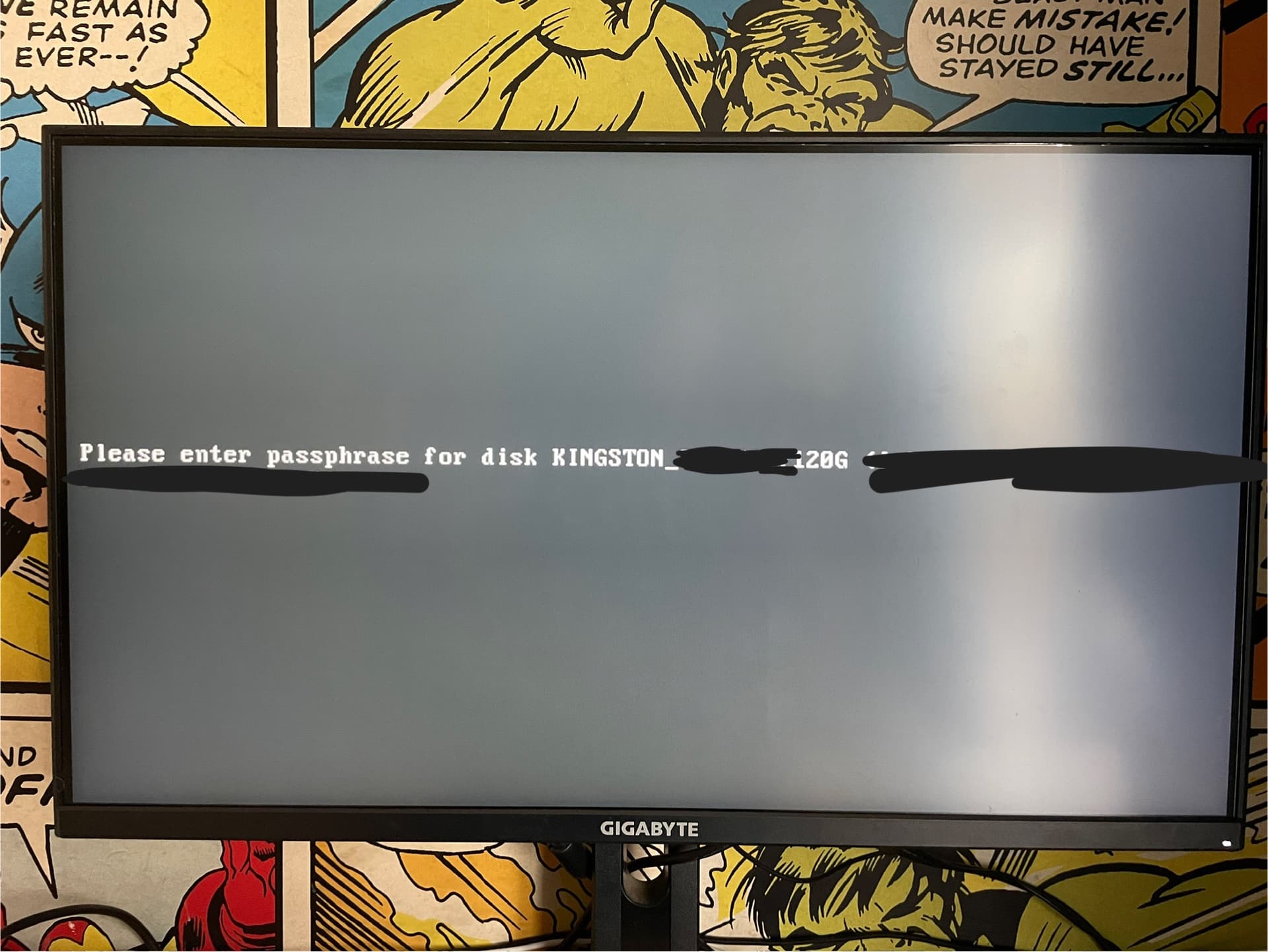

Hello, I have this issue for the 2nd time. I’ve updated dom0 and reloaded my pc and now I see this strange “please enter passhrase” window, and after I enter my passphrase I see only blinking cursor in upper left corner.
It’s not loading into login window or anything at all.
For the 1st time it’s happened I thought I’ve reloaded the pc while the dom0’s update was in the process and something has gone wrong. I’ve tried a lot of methods from google and gpt, but nothing worked, then I’ve just tried to manually backup my qubes and settings (I didn’t have a backup), but when I restored it, it broke my sys-usb (or something, I don’t know). So, I’ve decided to backup on external drive every time I want to update or just shut down the pc.
And after the new dom0 update, I see this again.
My hardware is rtx 4070 super and gigabyte b550 ds3h

Actually I don’t see any “quiet” option in the grub editor. I’ve tried to load into text based mode (with option 3) and it worked, I’ve logged in, so I guess the problem with the gpu?

I’m not sure what is kernel and what is GRUB. Like when I load into Qubes’ drive I have menu with 2 options: simple boot and with advanced options where I can choose version of kernel. I’m selecting the first one (simple) and click edit. I’ve also tried to boot using all kernel versions from advanced options.
What can I do then if the problem in the GPU?

It seems my motherboard and other things should work fine, but the problem in GPU, so I asked this question to Gemini. It said that I can buy some AMD gpu, because it has default support of drivers. I’m thinking to buy one used radeon card. Something like RX 550 \ 570 \ 580. They all are like $50.
Buying a cheap AMD card that supports the resolution and output of your screen(s) is the best fix. Nvidia support isn’t really good on Linux except when installing there drivers, but it’s not really automated on qubes os so it’s quite painful to go through.
I had same problem, I fixed it with a new GPU from AMD and it worked a lot better.
