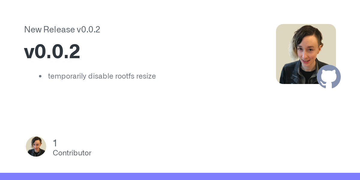

@evq I tried to create an AppVM based off of the nixos template, and it seems to be stuck during boot:
A start job is running for Adjust root filesystem size
Let me know if you need the entire console, or anything else.
@kalbasit hmm… try this new rpm instead for now, I’ll investigate:
@evq Thank you, this one works.
