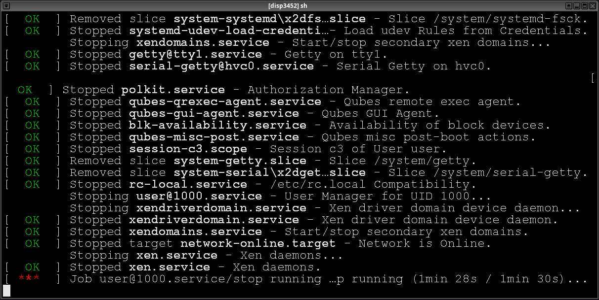

this is happening since I changed the template of my qubes from debian-12-xfce to debian-13-xfce:
when I shut down certain qubes, the shutdown process is delayed by 1min 30s. This is what’s shown in the console:
It happens only on certain qubes, and not always.

EDIT:
I found in /var/log/xen/console/guest-vault.log in dom0, that the service delaying the shutdown is “User Manager for UID 1000”.
Still no clue about the reason. I found not much more information there.
After some trial/error, seems that gpg-agent might be the most suspicious culprit.
EDIT: It seems it is the culprit (combined with yubikey-touch-detector).
