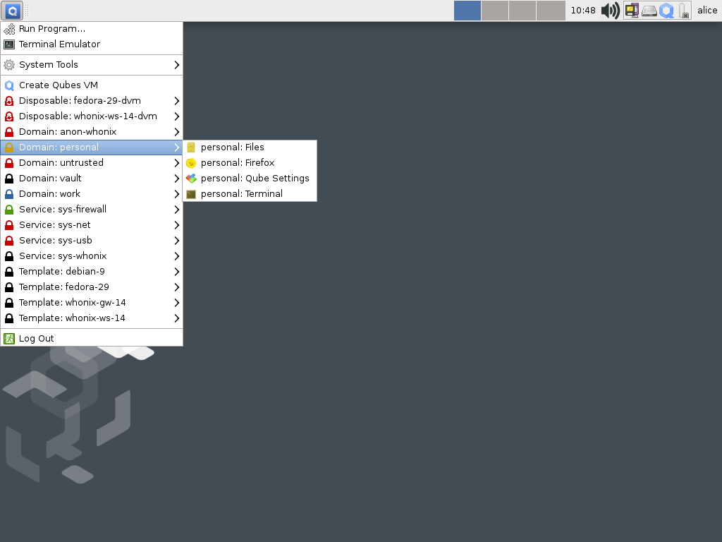

You should see this list:
  • dom0
  • anon-whonix
  • debian-12-xfce
  • default-dvm
  • fedora-41-xfce
  • personal
  • sys-firewall
  • sys-net
  • sys-usb
  • sys-whonix
  • untrusted
  • vault
  • whonix-gateway-17
  • whonix-workstation-17
  • whonix-workstation-17-dvm
  • work
The Qubes icon should be on the upper-left of the screen by default, not upper-right. The Qubes documentation is outdated and still displays the Qubes 4.1 version of the Qubes Application Menu:
