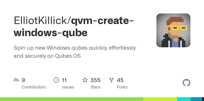

Would running Windows 10 in a qube work for you? If not, please share (if you are in a position to) why not so others can find a fix or workaround.

Yes:
