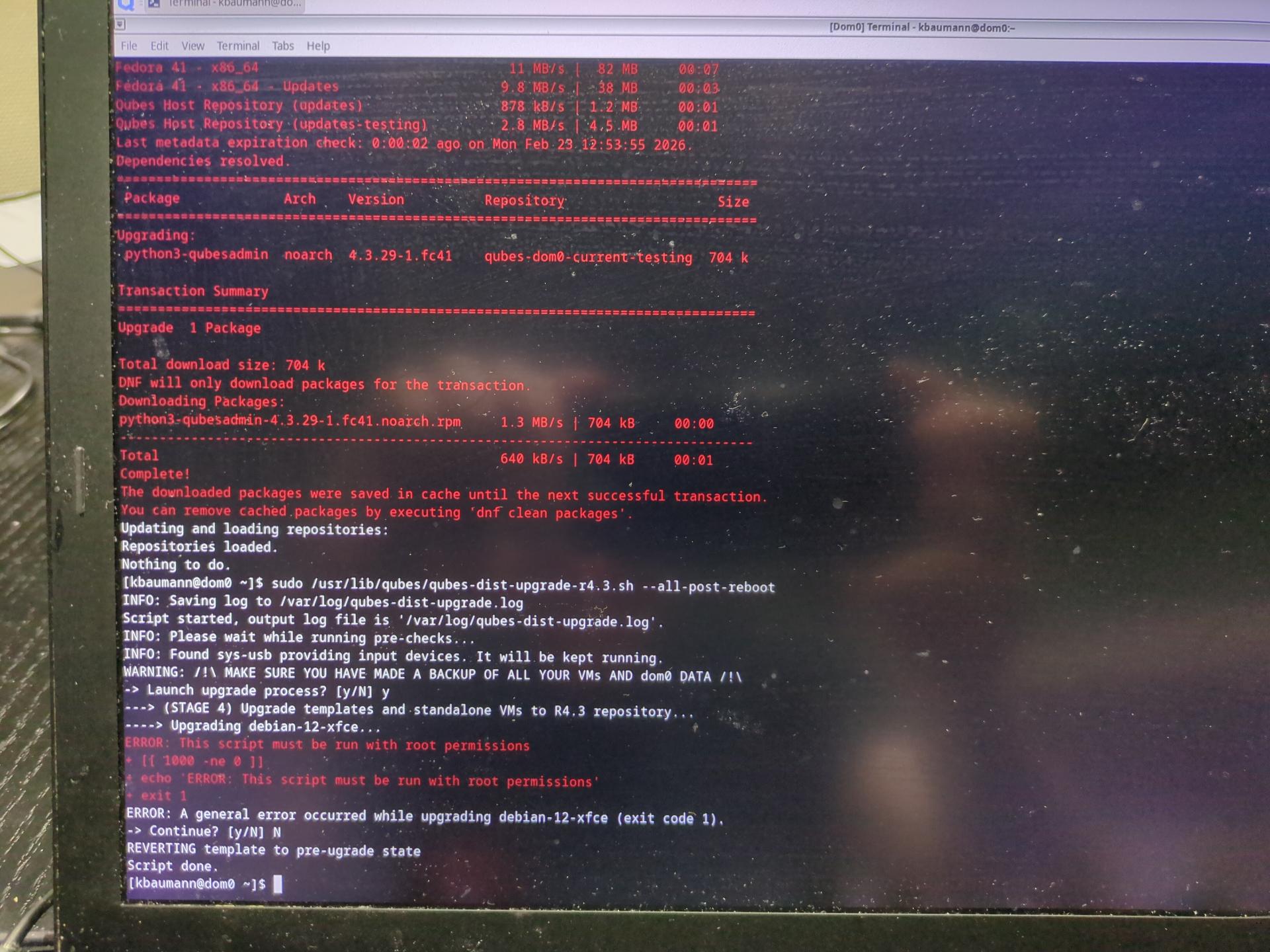

Not for me. Just tried it.
Just looking at your output two items stand out, that the new package was downloaded and cached, and that qubes-dist-upgrade failed on a debian-12-xfce template. I only tested on a debian-12-minimal template, which was successful.
If the package was downloaded and upgraded, then you should be able to see the following (new) lines of code (at lines 299 and 1487, respectively):
user@dom0:~$ cat /usr/lib/python3.13/site-packages/qubesadmin/tests/tools/qvm_run.py | grep too_old
    def test_040_run_root_shell_too_old(self):
user@dom0:~$ cat /usr/lib/python3.13/site-packages/qubesadmin/tools/qvm_run.py | grep force-user
            # got also force-user=root setting necessary for the below to work.
Thanks, that solved the problem for me. The following command finished now without errors:
sudo qubes-dist-upgrade --releasever=4.3 --template-standalone-upgrade
All my templates are up-to-date again and the problems with the debian 12 mininal and xfce templates are gone. Thanks to everyone involved in fixing the issue! :slight_smile:
