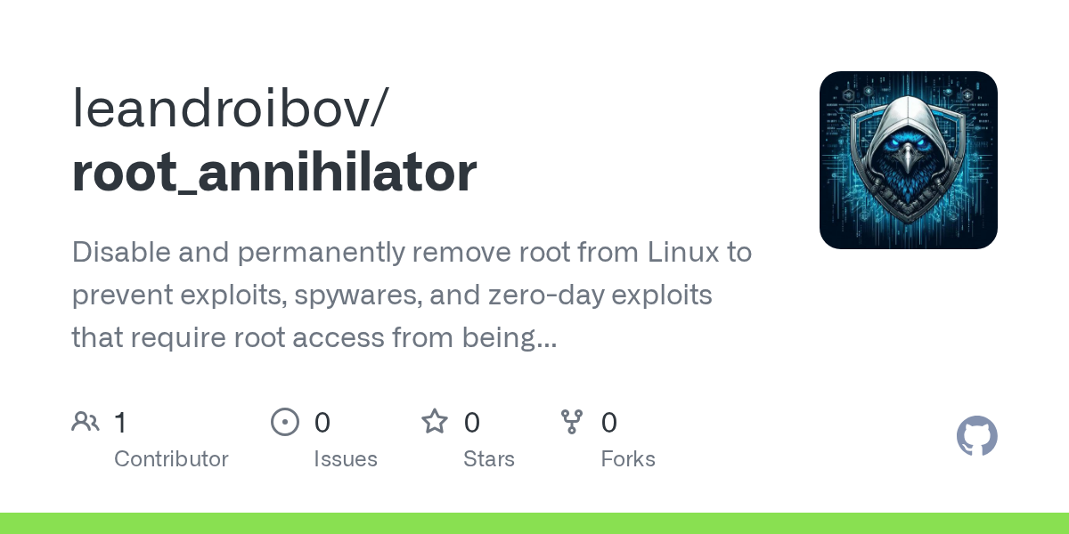

I tested the root_annihilator script to strip root access in AppVMs and Disposable VMs using the procedure below:
What improvements could be made to the script so that it matches or exceeds the “no‑root” mode used by Tails?
Any suggestions would be appreciated. Procedure I Followed
In the target AppVM or Disposable Template, clone the VM to create a backup.
Edit /rw/config/rc.local inside the VM:
sudo nano /rw/config/rc.local
Copy and paste the contents of the script located at:
Save the file and reboot the system.
On each boot, /rw/config/rc.local runs the root_annihilator script by /rw/config/rc.local !
Result
Root can no longer be used to run arbitrary scripts or perform privileged tasks, but it is still possible to execute updates with sudo, for example:
sudo apt update
sudo apt upgrade
Is it possible to completely eliminate this capability? Or is it safe enough to leave it as is?
Why I BackUp the VM
Modifying /rw/config/rc.local becomes impossible once the VM boots without root, because the script disables root. To edit the file again, I would need to mount the VM’s disk partition from another environment and manually change the script something that is far more cumbersome than simply restoring the cloned backup.
